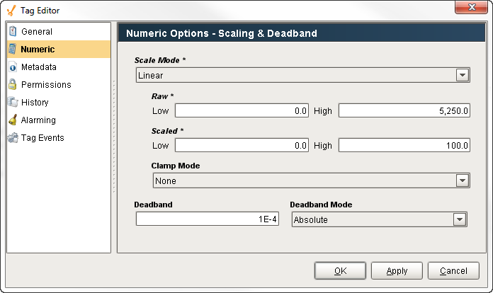

Configuring a Tag's scaling will condition the data for use within the Ignition Designer. Scaling will take the raw PLC value driving a Tag, do some math, and use the resulting value as the value of that Tag. And scaling works both ways! When you write to that Tag, Ignition will scale it in the opposite direction before writing to the PLC.
For example, if the capacity of a tank is 5250 gallons, but the tank's fill level is better represented in the Designer as percentage of 0 through 100, configuring the Tag's scaling property, will result in the Tag displaying 0 through 100, while the actual tank fill moving is between 0 and 5250 gallons. For this example, you can click on the Tag to open the Tag Editor, then click on Numeric. This allows you to configure the scaling of the Tag. When scaling between a Raw Low and and High, and Scaled Low and High, select the Linear Scale Mode. So what Ignition is actually doing, is setting up the calculations behind the scenes to scale the value appropriately.
If you are using scaling...
The numbers and units don't have to match-up. Scaling is straight from one number to another number. It doesn't matter what the units are, and it doesn't matter what the conversion is. What is important, is that the data type of the Tag must match the data type of the scale value. IE: dividing an integer in the PLC by 10 probably means your Ignition Tag should be a float.

The value will be scaled linearly between the low and high values, and clamped as appropriate. The linear equation is:
ScaledValue = ΔS * (Value-RL)/ΔR + SL

  • Raw Low: 0.0
  • Raw High: 100.0
  • Scaled Low: 0.0
  • Scaled High: 10.0
4-20 Milliamp Signal to Percent​
This is common when using a simple pressure sensor. The sensor is calibrated to send 4 milliamps (minimum value) when the tank is empty, and 20 milliamps (maximum value) when the tank is full.
  • Raw Low: 4.0
  • Raw High: 20.0
  • Scaled Low: 0.0
  • Scaled High: 100.0
4-20 Milliamp Signal to Gallons​
This is common when using a simple pressure sensor. The sensor is calibrated to send 4 milliamps (minimum value) when the tank is empty, and 20 milliamps (maximum value) when the tank is full (5000 gallons).
note
There is no direct conversion between amps and gallons. In scaling it doesn't matter.
  • Raw Low: 4.0
  • Raw High: 20.0
  • Scaled Low: 0.0
  • Scaled High: 5000.0
