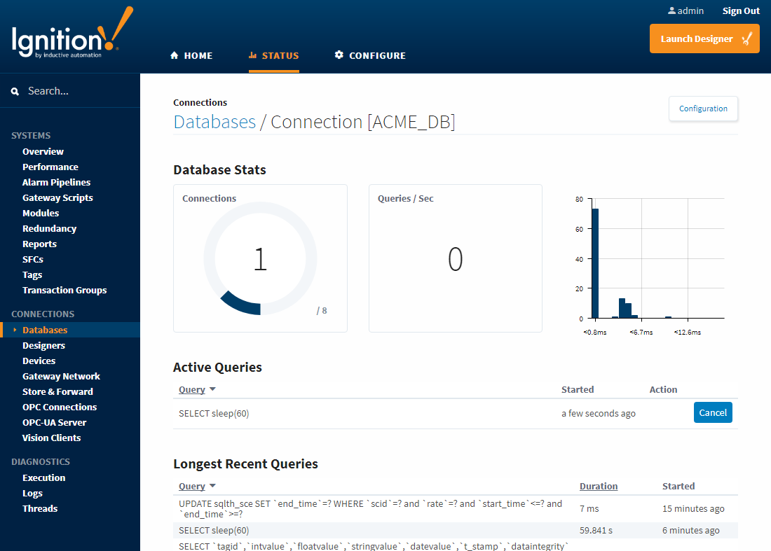

Identify the Slow Query​
The first step in dealing with slow queries is identifying which query is actually running slowly. It is typically obvious when a window is opened and a component takes time before database data is displayed. Chances are, the query is on that component somewhere. However, it may also be a good idea to check the queries that are being run against that database connection in the Gateway. From the Gateway webpage, navigate to Status → Connections → Databases to see a list of all database connections. Clicking on the Details button to the right of the database connection will show all of the currently running queries, the most recent long running queries, as well as some basic metrics for that connection. Here, you can get a good idea of any queries that may be a little slower than the others.

Check Currently Executing Queries​
Back in the Status section of the Gateway Webpage on the Database Connection page mentioned above, we can see a list of currently running queries, as well as how many of the active connections are being used. If the max number of connections is being used, it may be that there are so many queries running that each query needs to wait for an active connection to open up. If this is the case, you may want to increase the amount of active connections to the database or take steps to reduce the query load on the database.
