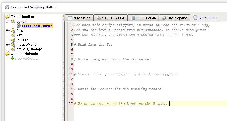

Add Comments​
While comments are useful to remind you how your code works, you can also use them to plan your script before you write any code. Break down what you want the code to do into several smaller steps, and then leave comments describing those steps in order. This provides you a chance to review the script's workflow before worrying about syntax. It also provides natural points to stop and test your code, to make sure it is doing what you think it should do.
