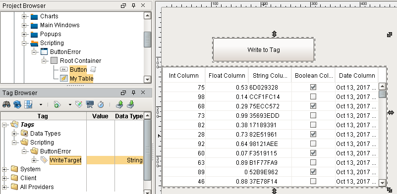

Here we have a window with two components: a Button and Power Table. The purpose of the button is to find which cell in the Power Table the user selected, and write the value to a Tag.
The code on the button is listed below.

+ event = actionPerformed event + source = Button this script is placed on + parent = Container that the Button was placed in. Based on the Button's position in the window, this appears to be the Root Container. + getComponent('Power Table') = Should return a reference to a component named 'Power Table' directly inside of the Root Container, assuming one exists. If we take a look at the Project Browser, we see the following:
There is no component named 'Power Table' in the Root Container. However, there is a Power Table component named 'My Table', so it appears someone renamed the component, which caused our script to initialize the variable table as a 'NoneType' instead of a reference to a component.
Solution​
To fix this issue, we can simply update our code to use the new name of the Power Table, which is 'My Table'. We can type this in manually, but since it is case sensitive, it must match exactly. It may be easier to find the Name property on the component, copy the name to the system clipboard (Ctrl-C), and paste it (Ctrl-V) into the script. Our code now looks like the following:

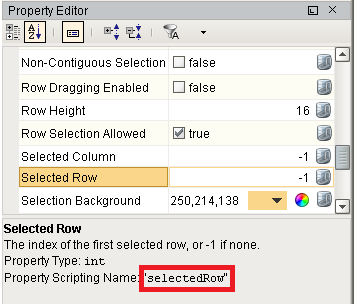

Again, the exception refers to line 5, but note that the error mentions a different object and attribute this time. Without knowing what a com.inductiveautomation.factorypmi.application.com object is, we can tell that our script is trying to reference an attribute named selectedrow. This gives us a starting point for troubleshooting the error. If we check line 5, we see the following:
Python - Line 5
userSelectedValue = table.data.getValueAt(table.selectedrow, table.selectedColumn)
We see table.selectedrow as the first parameter being passed to the getValueAt() function. We checked into the table variable earlier, so this doesn't necessarily mean that the variable is the problem, although there is no harm in double checking, especially if you have not personally verified the variable. Assuming that the table variable is correct, let's check the attribute. We can check the Property Editor in the Designer to find a matching property, or head over to the Power Table page in the manual and check the property reference. We can see that there is a Selected Row property on the Power Table, but it should be spelled "selectedRow" with a capital "R".
We also know that the getValueAt() function takes a row index as the first parameter, so it would make sense that our code has a typo.
Solution​
We should fix the typo in the attribute name.
Python - Line 5 Updated
userSelectedValue = table.data.getValueAt(table.selectedRow, table.selectedColumn)
