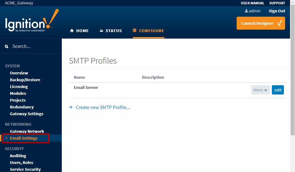

Setting up an SMTP Profile​
The Email Settings page allows you to configure an SMTP server connection that can be used by several different resources in the Gateway. This means that instead of setting up an SMTP server connection within each resource (i.e., Alarm Notification Profile, Reports, etc.), you can configure them once here, and have those resources all use the same SMTP server. You can find the Email Settings in the Configure section of the Gateway Webpage under the Networking heading. Here, you can create a new SMTP Profile, or manage your existing profiles.
