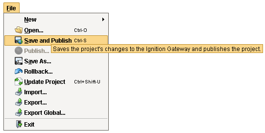

Publishing in Auto Mode allows you to save and publish an entire project with one button press. You'll notice that the Save and Publish option (under File) is available when the Publish Mode is set to Auto. By default, the Publish Mode is set to Auto.
Publishing in a Project in Auto Mode​
Let's publish an entire project using Auto Mode.
  1. Open your Designer and a client. If you don't have a project already, create a new project when opening the Designer, then open a client of it.
  2. In Designer, open one of the windows (or create a new one) and make a few edits. You can drag components onto the window for obvious changes. When you're ready to publish your project, go to the menubar, and select File > Save and Publish. Unlike Manual Mode, Auto lets you Save and Publish using one command.

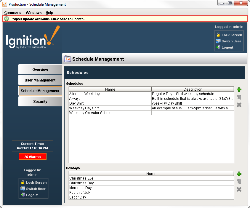

  1. Now go to your opened client and you'll see the Update bar at the top of the screen. Click it to pull the new changes into the client. Depending on your changes, it may not show the additions automatically. You may have to logout and log back in again.

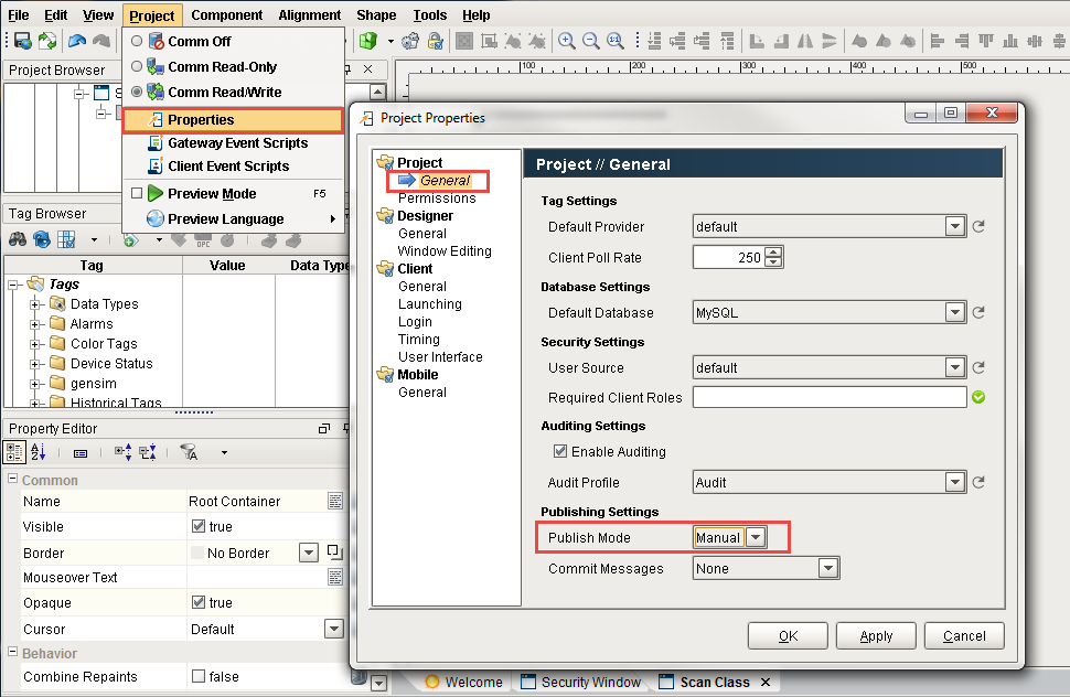

To Set the Publish Mode to Manual​
  1. In Designer, go to Project > Properties, and select Project > General.
  2. Set the Publish Mode to Manual, and press OK.

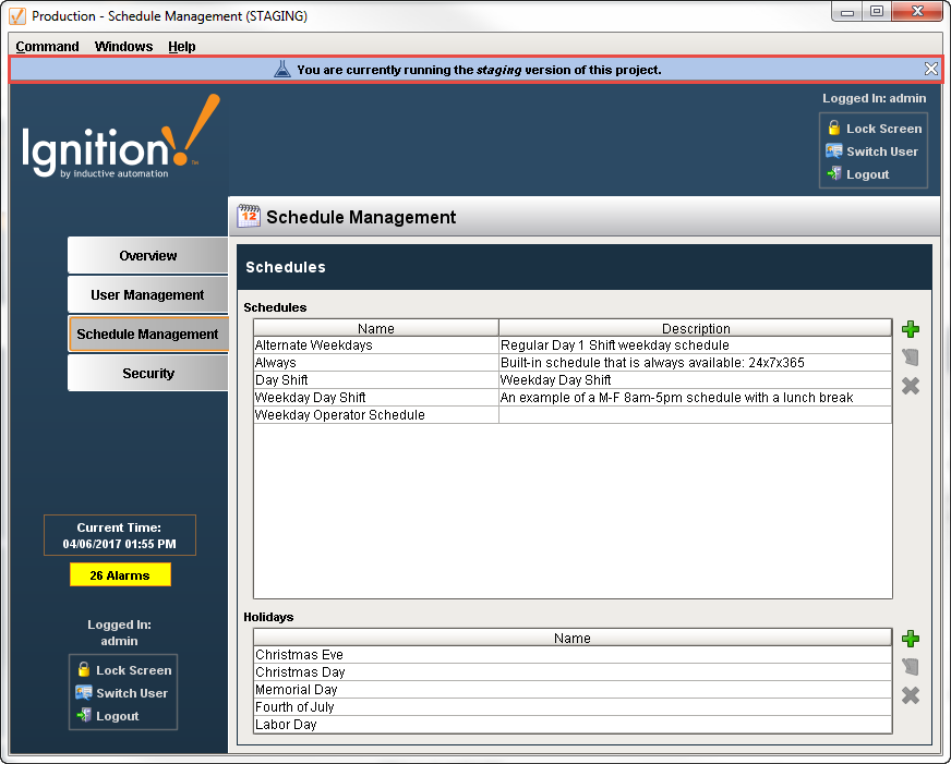

  3. At this point, we have saved but unpublished resources. If you would like to see and test these changes before publishing them, you can open a staged Client from the Designer. Go to the menubar and select Tools > Launch Project > Windowed (Staging). This will give you a Client with a blue banner at the top showing that you are running a Staging Client instead of a normal Client.

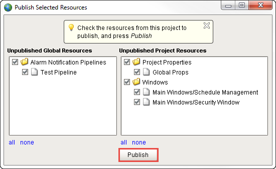

  1. Now that you have saved but unpublished resources, we can publish them. Go to the menubar and select File > Publish.

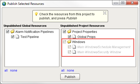

  2. The Publish Selected Resources window will open. By default, Ignition will select all the resources, both Global and Project Resources, that were saved since the last time any items were published. If you see any resources that are grayed out, it means that those items were committed but not saved. If you want to publish the grayed out items, close the Publish Selected Resources window, save your project, and then go back to the menubar, and select File > Publish.
  1. If there are any resources you don't want to publish, unselect those resources. When you're ready, click Publish.
  1. Now go to your standard Client (not Staging) and you'll see the yellow bar at the top showing there is an update. Click it to pull the new published resources from the Gateway.

Your Staging Client will not receive an update when you Publish.
