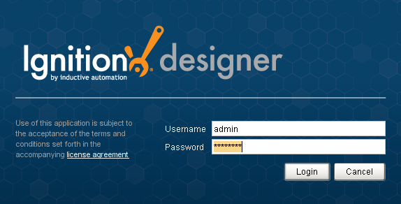

  1. Click Launch Designer on the upper-right of any Gateway page. Depending on your web browser, it will ask you if you want to save or run a designer.jnlp file.
  2. Run the designer.jnlp file to start the Designer. The Designer starts up and the login window is displayed.
  1. Enter the default username and password for the Designer which is the same for the Gateway Configuration section.
    Username: admin
    Password: password
info
This assumes that this username and password were not yet changed. If this username and password does not work, then the default username and password are no longer valid. Please refer to Security to understand further how Ignition manages its users and their passwords.

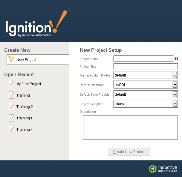

  1. Click on Login. The Open/Create Project window is displayed giving you two options, to create a new project or open an existing one. If you don't have any existing projects yet, we will create a new project.
  1. In Project Name, enter a name for your new project (no spaces!).
  2. For Project Template, select a template from the drop-down list, for example, you can select the Single-Tier Nav, West & North template. Rather than starting from a blank project, the templates let you start from one of the skeleton projects that already have navigation windows setup. These projects are completely customizable and are designed to help you get started faster.

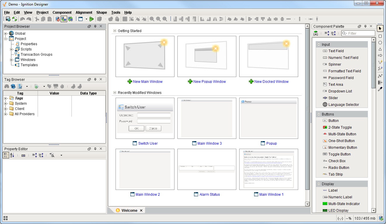

  3. Click on Create New Project. The Designer is now launched and you can work on your project.
Once in the Designer, your can create or open a project using the Designer's File > Open menu. The Open/Create Project window is displayed and you can follow the same steps as above to open existing projects or create a new one.
