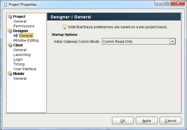

Using the Project Properties Window​
This will change the default Comm Mode that the designer starts up in for the current project.
  1. In the Designer, either double-click on the Project > Properties node in Project Browser, or click on the Project > Properties command on the top menu.
    The Project Properties window is displayed.
  2. Go to the Designer > General setting section.
  3. Under Startup Options, for the Initial Gateway Comm Mode, choose from the dropdown Comm Off, Comm Read-Only, or Comm Read/Write.
note
These property settings are saved on a per-project basis.
