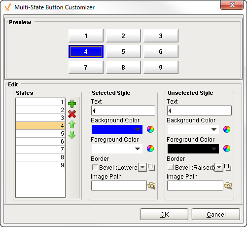

Customizers​
The Multi-State Button has its own Customizer. Here, you can define your states, change the order, values, and styles. You can organize your buttons to be a column, row, or grid by setting the Display Style property in the Property Editor. You'll notice that the Multi-State Button Customizer already has some preset states and pre-defined styles to help you get started.
The Multi-State Button works by defining a set of visual styles that change based on a single State. When one of the buttons is pressed, its state value is written to the Control Value property and the Indicator value, and then the visual style will change.
Multi-State Button Customizer Property Descriptions​
| Property | Description |
| Preview | Lets you preview each button's display style, states, and the selected style and unselected style as you configure it. |
| States | Shows a list of all possible states. You can add, remove, and the change the order of each state listed. Each state also defines two visual styles for a button: Selected Style and Unselected Style. |
| Selected Style | Shows the visual style when the button is selected. You can configure the styles you want to change: Text, Background Color, Foreground Color, Border type, and even add an Image. |
| Unselected Style | Shows the visual style when the button is not selected. You can configure the styles you want to change: Text, Background Color, Foreground Color, Border type, and even add an Image. |
| Text | Text displayed on the button. |
| Background Color | Color of the button |
| Foreground Color | Color of the text |
| Border | Type of border around the button |
| Image Path | Relative path name for an image on the button |

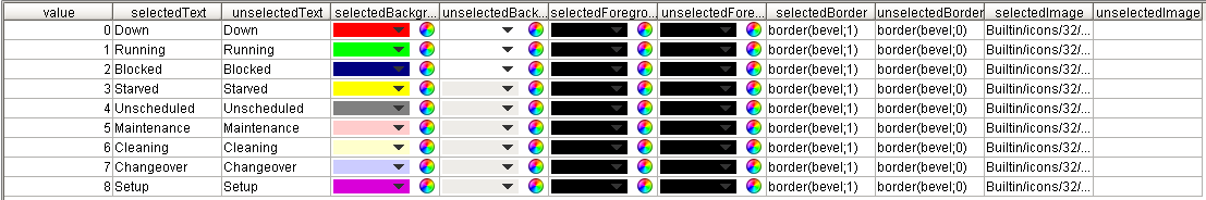

The Multi-State Button component in this example has its Display Style property set to Grid. Each button represents an integer-valued state. Each state defines two styles for a button: the selected style, and the unselected style. When a button is pressed, its state's value is written to the submit your changes property. The displayed state is based on the Indicator Value property.
Example​
| Property Name | Value |
| Display Style | Grid |
| Styles | ![]() |
