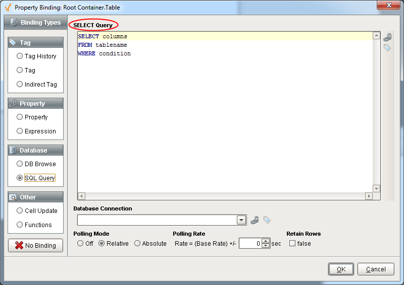

The SQL Query binding is a polling binding type that will run a SQL Query against any of the database connections configured in the Gateway. It is very similar to the DB Browse binding type in that both query a database to return data. The difference is the SQL Query Binding can manually be modified. This is useful for complex queries where you will use the more advanced functions of the SQL language that can not be accomplished with the DB Browse binding.
tip
The query that gets generated by the DB Browse will transfer over to the SQL Query binding when you switch the binding type. It may be useful to build the basic query structure with DB Browse first, then switch to SQL Query binding to modify the query to fit your needs.
Dataset Binding​
The majority of SQL Query bindings will return a dataset (and are usually Dynamic). These will usually return many rows with multiple columns. For example, showing all customer details from a certain account, or all downtime events in the facility. The only important distinction here is that if you are returning multiple rows and/or columns, you need to put that binding on a property of type dataset like the Data property on a Table component. Basic data types like integers or strings can only show the first value of a query result, not the whole set. You can easily see the difference in the binding window because only basic data types will show two query entry fields, SELECT and UPDATE. Dataset properties only show SELECT.

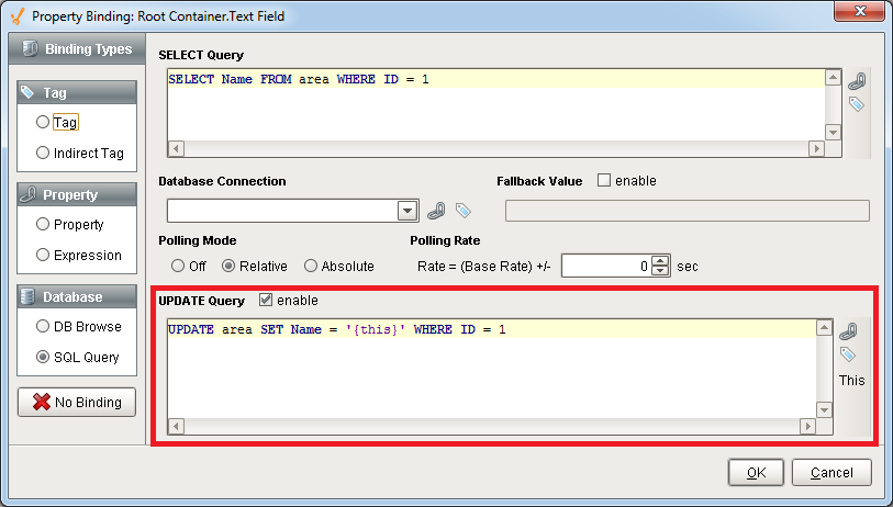

You can bind an input component bidirectionally to a SQL query to allow data be retrieved and updated in the database. This can only be done with a Scalar Query on a non Dataset property. Essentially, we mimic the bidirectionality of Tag and property bindings by adding in an update query to run whenever a value gets entered into the property with the binding. In our update query, we use the special parameter to denote the new value from the bound property. If is a string, it needs single quotes around it.
SQL Query Binding: Scalar Query Update
Take a Text Field with a simple query on it.
SQL - Simple Select Query
SELECT Name FROM area WHERE ID = 1
This will return a single value that can populate our text field. We then enable the Update Query at the bottom of the Property Binding window, and add in the update query.
SQL - Using Ignition's 'this' Keyword
UPDATE area SET Name = '{this}' WHERE ID = 1
After confirming the binding, we can see that our text field contains the value from the database and will update the database cell if we enter in a new value into the text field. This is a good way to alter very specific cells in a database table.

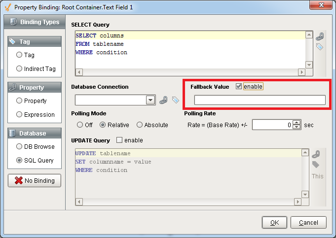

If the property that is being bound is a scalar datatype (that is, not a Dataset), the value in the first column in the first row of the query results is used. If no rows were returned, the binding will cause an error unless the Use Fallback Value option is selected. The value entered in the fallback value text box will be used when the query returns no rows.
When binding a Dataset to a SQL Query, no fallback value is needed, because a Dataset will happily contain zero rows.
