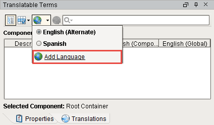

  1. In the Designer, right click in your workspace and select Translations from the dropdown. The Translatable Terms window will open.
  2. Select the Earth icon and click Add Language. By default, the English language is defined.
  3. Select a new language from the dropdown. That's all there is to it! You can create as many languages as you need for your project.

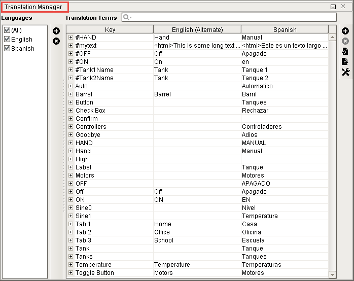

  1. From the menu bar at the top, go to Tools > Translation Manager.
    The Translation Manager window will open, and you can view all the terms that were added. This example has terms that were already added and translated.
    On the right side of the window, there is a list of icons where you can add, delete, import, export, and edit the Translation settings.

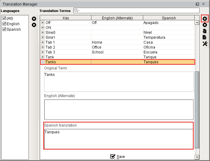

  2. To add a new global term, click on the plus icon. Enter the term (Tanks), and press OK.
  3. Double click on the row of the new term, and under Spanish translation enter the word 'Tanques.' Click Save.

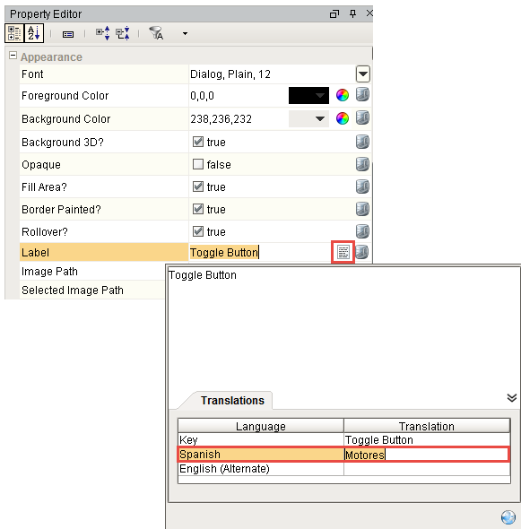

  4. For Text components on a screen (i.e., Label, Button, Toggle Button, etc.,), you can add translations in the Property Editor. Under Appearance, click on the text box next to the name of the text component. Click the Translation Button at the bottom of the text window. Click the green plus icon to add a translation. After you enter the translation, hit enter. The term will be added to the global translation database.
  5. To view all the global terms added to a project, go to Tools > Translation Manager. If you want to provide a translation to a term that has not been translated, double click on the row of the term, enter the translation, and click Save.
  6. Now, let's test it out! Drag a Language Selector component to your window. Go into Preview Mode and toggle the languages. You will see the languages for the text switch between English and Spanish for these two components.

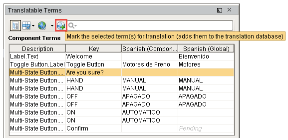

    In the Translatable Terms Panel, you have the option of adding your translation to the Component, Translation Manager global database, or marking it for translation at a later time. You'll notice under the Component Terms section of the Translatable Terms window that there are four columns; Component Description, Key, Component translation, and Global translation.
    You'll see below all the terms for the Multi-State Button, and none of the terms have translations added. If you don't see the language you want your terms translated to, click the Earth icon and select the language (i.e., Spanish). You will then see a column for your component translation and global translation.

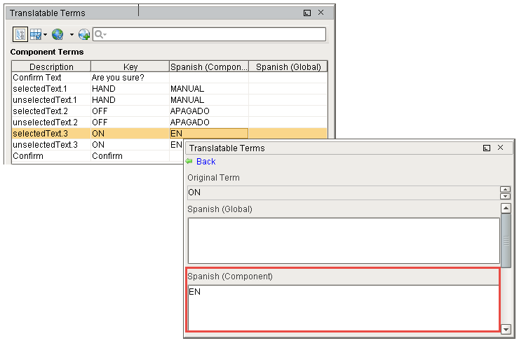

  3. To add translations for your component terms, double click the row of your term (i.e. ON). In the Spanish Component box, enter the translation (i.e, EN). You also have the option of creating a global translation on the Translatable Terms Panel as well. Then, click the Back link, and repeat this step for all your terms.
  4. Once you entered the translations for all your terms, you will see them on the Translatable Terms Panel in the Spanish (Component) column. If a term doesn't have a translation, you can select the term and mark it for translation by clicking the Earth with a green plus icon. This adds the term(s) to the translation database for someone else to add the translation. In this example, you'll notice several things about each of the terms so look closely at them. You'll find examples of both component and global level terms, a component level term, a global term, a component term that overrides a global term, and terms marked for translation.

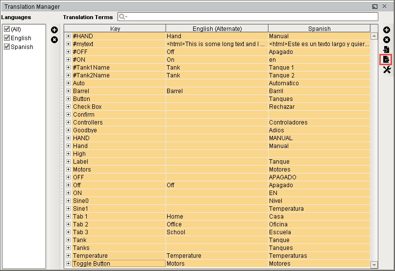

To Export Terms from a Window​
Let's export some terms from the Translation Manager. In this example, you can see all the terms that were added to the Translation Manager. You can export selected terms, or all terms from the Translation Manager.
  1. Go to Tools > Translation Manager. Select all terms or only specific terms to export. Click on the Export Terms icon on the right side of the Translation Manager window.

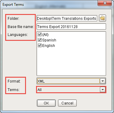

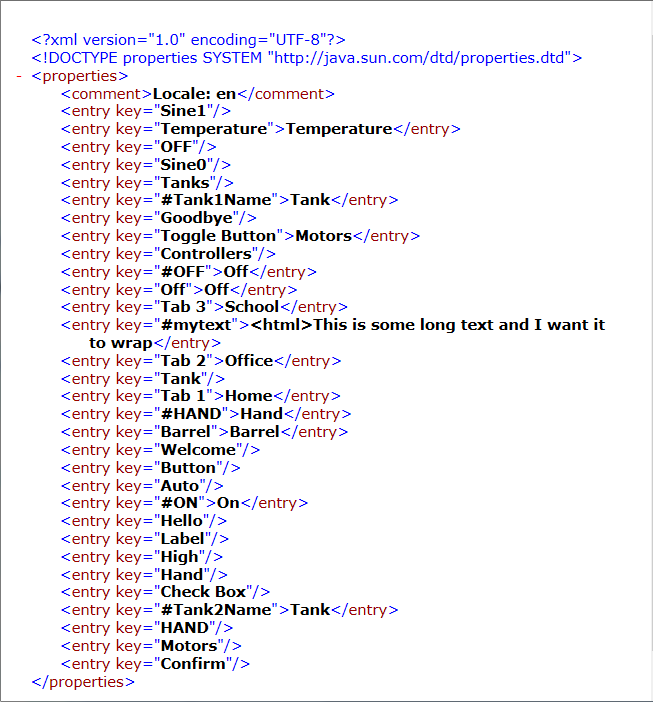

  2. The Exported Terms window will open. Enter the following information:
    1. Select the Folder location where you want to put your exported terms.
    2. Enter the Base file name. (File name of your exported terms).
    3. Select the appropriate Languages. You can have multiple languages selected depending on the number of language translations you are using (i.e., English, Spanish, and French). This example exports two files: one for the English translation, and one for the Spanish translation.
    4. From the Format dropdown list, select either PROPERTIES or XML. Both formats behave the same, the only difference is that the XML format supports UTF-8 encoding directly. A person can now translate the XML file directly and import it back into Ignition's Translation Manager.
    5. From the Terms dropdown list, choose either Selected or All.
    For Specific Terms
    If you want to select specific terms to export, choose 'Selected,' otherwise, 'All' terms will be exported from the dropdown list at the bottom of the window.
    1. Press OK.

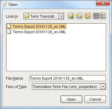

  3. Go to the folder location and check to see if your exported files are there. You will see one exported file for each language. Open the English exported file and verify that all the terms you intended to export are there.

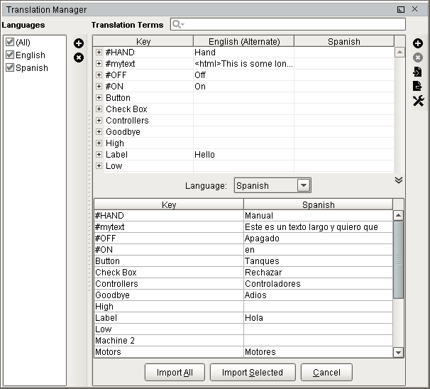

To Import Terms into Ignition's Translation Manager​
  1. Go to Tools > Translation Manager and select the Import Terms icon from the right side of the Translation Manager window.
  2. Navigate to the folder where your exported files reside, and choose the English file from the Open window, and click Open.
  3. You have the option of importing selected terms or all terms. Click either Import All or Import Selected depending on what terms you want to import.
    Repeat this step to import each translation file. This example imports the Spanish translation file.
    Imported Terms Overwrite Existing Terms
    Be aware that existing terms will be overwritten by the imported term.
  4. Check to see that all your terms were imported into the Translation Manager by going to Tools > Translation Manager.
