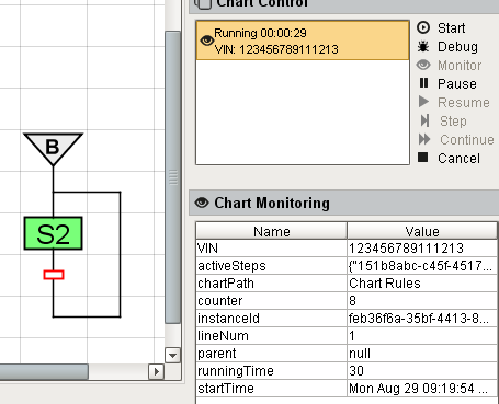

Chart Monitoring​
Once chart-scoped variables have been defined, their values can be viewed while the chart is running in the Chart Monitoring section. This allows for easy troubleshooting from the Designer. More details can be found on the Monitoring and Debugging Charts page.
