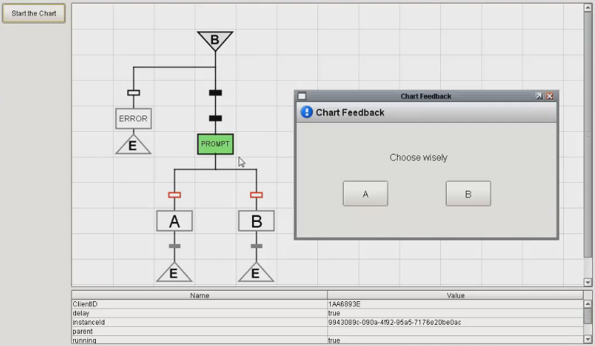

Interaction and Monitoring​
While SFCs are run in the gateway, Ignition has tools to help you interact with and monitor charts in the client. There is a chart monitor component that you can use to see the status of your SFCs in the client, there are scripting tools to start, stop, pause, and resume charts from the client, and you can send operator input to a chart with scripting functions.

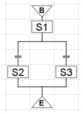

Branching Transition​
In this example, step S1 executes as above, except that it has two transitions beneath it. This is how you do conditional logic in a chart. S1 runs until either of these transitions becomes true. When one transition becomes true, flow will follow that branch of of the chart. If both transitions are true, the transition on the left is chosen. Position is meaningful for charts - transition precedence goes from left to right.
Only one of S2 or S3 will run, but never both.

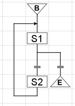

Loop​
In this example, S1 executes as above, looping until one of the transitions becomes true. If the branch to S2 becomes active, S2 runs once and then S1 starts looping again immediately. This way the chart can execute multiple times.
This is how you configure repeating logic in a chart. The two transitions determine whether this chart continues running (possibly indefinitely) or stops.

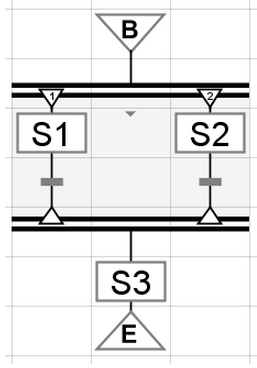

Parallel Execution​
In this example, steps S1 and S2 execute simultaneously. They both continue to run until the transitions beneath them become true.
Flow only moves past the parallel sync (the bottom of the parallel section) once both transitions become true. Step S3 then runs, and then the chart stops.
