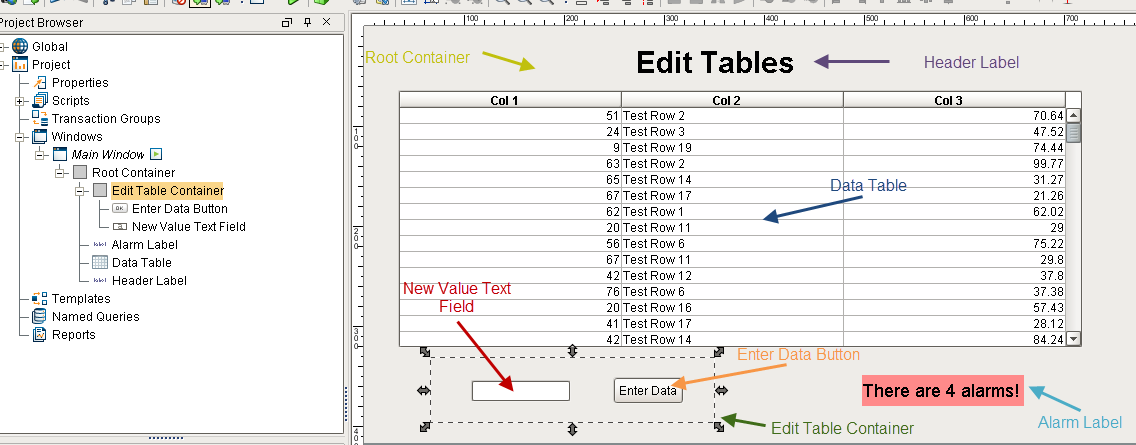

Every window in a project has a hierarchy to it, with components and containers arranged in a tree structure, with a single parent up at the top, and many children down at the bottom. While small windows with only a few components can have a simple hierarchy, windows with many containers can get much more complex. Since the components are arranged like a tree, this means that we can only move up and down through the tree structure and not sideways. To get from one component to a sibling component, we must first navigate up towards the common parent, and then back down to the desired child. Let's take a look at an example of how this works. Here we have a simple window, with just a few components:
  • Root Container
    • Edit Table Container
      • New Value Text Field
      • Enter Data Button
    • Alarm Label
    • Data Table
    • Header Label
We can flip the tree around to get a better understanding of exactly how the tree works:
Here we can get a better idea of why we can only move up and down through the tree structure, and how getting to a component can be very different depending on where you start. Let's say we want to go to the New Value Text Field so that we can grab its value.
Start FromPath To New Value Text Field
Edit Table Container1. Down to New Value Text Field
Enter Data Button1. Up to Edit Table Container
2. Down to New Value Text Field
Data Table1. Up to Root Container
2. Down to Edit Table Container
3. Down to New Value Text Field

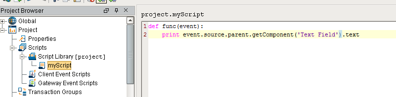

Project and Shared Scripts are unique in that how they access components can vary depending on where the Script Module is being called from and what is being passed to it. If the script module is being called from an event handler or an extension function, it is possible to pass in the event or self objects and use them within the script module.
Python - Accessing a Component from a Project Script
# This code would go in a project script. We are defining our function that takes an event object
# and uses it to find the value of the text property on the text field in the same container.
def func(event):
print event.source.parent.getComponent('Text Field').text
Python - Calling a Function from the actionPerformed Button
# On the action performed of a button on our window, we could then use this to call our function.
project.myScript.func(event)
