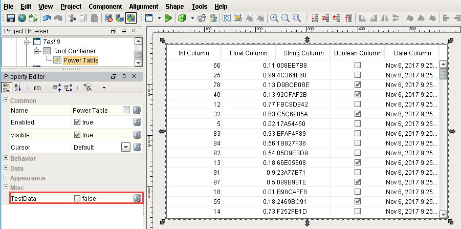

  1. Identify the dataset that you want to export to a CSV file. In this case, we can generate some data on a Power Table and export that data. Drag a Power Table component on to your window and toggle its TestData property to generate some data.

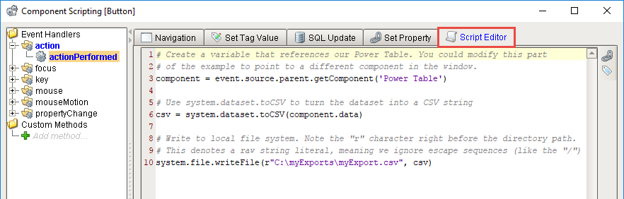

  2. Drag a Button component on the window, and double click on the Button to open the Component Scripting window.
  3. Next, let's add our script on the Button component's actionPerformed event. Select the actionPerformed event, and click on the Script Editor tab.
  4. Copy the contents from one of the examples below, and paste the contents to the Script Editor. Notice the system.dataset.exportCSV scripting function is used in the first example to export the dataset to a CSV file:
Python - Hard Coded Filepath
# Create a variable that references our Power Table. You could modify this part
# of the example to point to a different component in the window.
component = event.source.parent.getComponent('Power Table')
# Use system.dataset.toCSV to turn the dataset into a CSV string
csv = system.dataset.toCSV(component.data)
# Write to local file system. Note the "r" character right before the directory path.
# This denotes a raw string literal, meaning we ignore escape sequences (like the "/")
system.file.writeFile(r"C:\myExports\myExport.csv", csv)

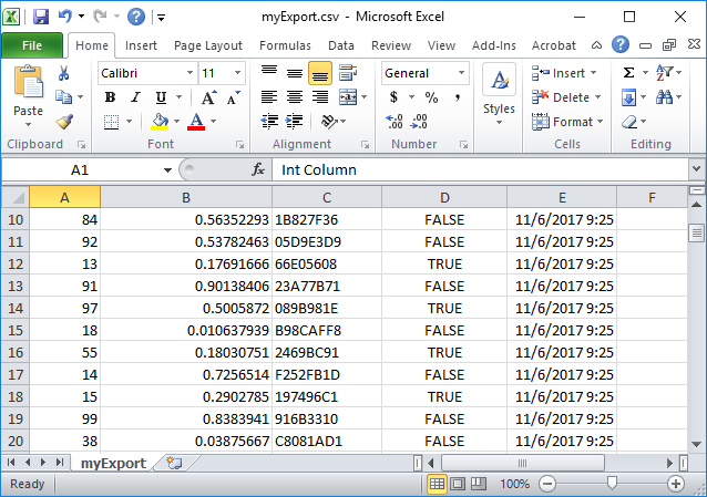

  1. To test your scripts, put the Designer in Preview Mode, and press the Button. Open your myExport.csv file and check your data.

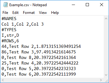

The system.dataset.fromCSV function can take a string and convert it to a dataset. Note, that the function expects a very specific format:
CSV File Content
#NAMES
Col 1,Col 2,Col 3
#TYPES
I,str,D
#ROWS,6
44,Test Row 2,1.8713151369491254
86,Test Row 3,97.4913421614675
0,Test Row 8,20.39722542161364
25,Test Row 4,20.39722542444222
33,Test Row 5,20.39722542232323
62,Test Row 6,20.39722542111999
Example​
  1. Create a Text file on your local system named "example.csv."
  2. Open the Text file, copy the contents of the "CSV file Content" box above, and paste the contents to the file. Save the changes to the example.csv file.

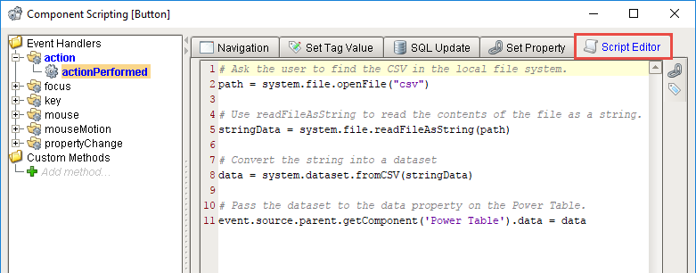

  3. Let's move the contents of a CSV file to a Power Table. Add a Power Table and a Button component to your window. Double click on the Button component, and paste the following code into the Script Editor of the actionPerformed event:
Python - Using system.dataset.fromCSV()

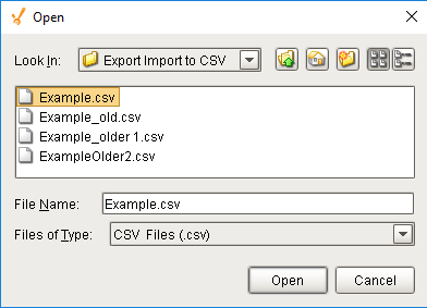

# Ask the user to find the CSV in the local file system.
path = system.file.openFile("csv")
# Use readFileAsString to read the contents of the file as a string.
stringData = system.file.readFileAsString(path)
# Convert the string into a dataset
data = system.dataset.fromCSV(stringData)
# Pass the dataset to the data property on the Power Table.
event.source.parent.getComponent('Power Table').data = data
  1. To execute your script, put the Designer into Preview Mode, and press the Button. A window will open for you for you to navigate and choose your CSV file, then click Open.
  2. Your data will be displayed in the Power Table as Shown below.
