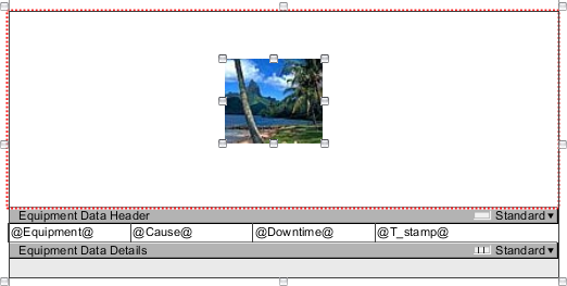

You can use the drag and drop feature to drag images from a local computer, shared drive, webpage, or the Image Management Tool to add images on a report. The report will display blue highlights around your report when you drop your image onto the report. No data key is required, and the dropped image will be used. Below, you can see a table header highlighted to drop an image in.
If you associate a key with an image component, the original placeholder image (as shown below) will still be seen in the Design panel, but will be replaced with the image associated with the data Key in the Preview panel. If the key does not link to a valid image, no image will be shown in the Preview panel.

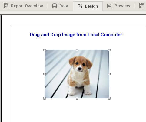

Drag and Drop an Image from a Desktop​
If you have a collection of images stored on your local computer, you can easy drag and drop any image into a report. No Key is required. You'll notice the Key property is blank. This doesn't mean you can't associate a Key with an image component. You most definitely can! The image will be replaced with the image associated with the Key when the report is generated. If you're going to use images from a local computer, it's a good idea to import those images to the Image Management Tool to make them visible and available to all project users.
To drag and drop images into a report from your desktop, head to the Design Panel. Find an image on your local computer, and drag the image directly onto the report. A new Image component will be created, and will be filled with you selected image. Note that the resulting Image component's Key property will be blank. This is expected behavior, as the image is embedded directly on the page, and not dependent on a key or file path.

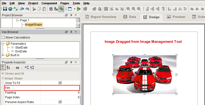

Images may also be dragged and dropped directly from the Image Management tool (Tools menu in the Designer > Image Management).
Go to your report and open the Design panel. Drag an image from the Image Management tool to your report. You'll notice that the Key property is blank. This is expected behavior.
Your image will be displayed directly in both the Design and the Preview panels.

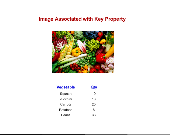

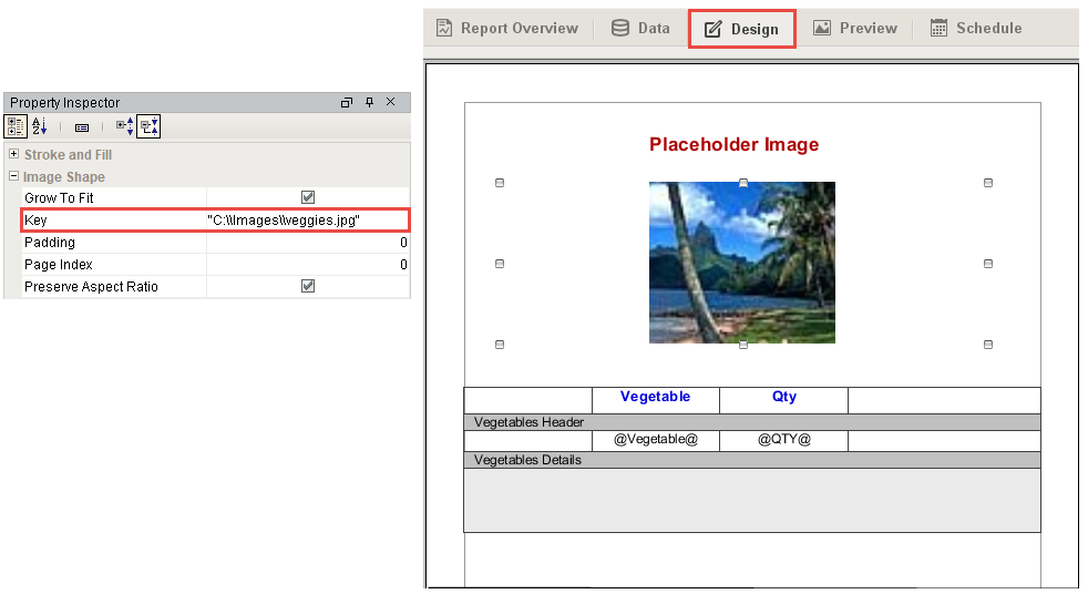

A static file path is created by dragging an Image component from the Report Design Palette into the Design panel, and manually typing the image path name into the Key property. The image path can point to a drive on a user's local machine, shared drive, or webpage. In this example, the image path is pointing to a user's local machine.
info
To paste a link into the Key property, use the Ctrl V command. Right clicking with your mouse to paste a link in the Key property is not an available function.
In the Key property, enter the path name where the image is located. You can type it in manually, or paste (Ctrl-V) the path name in the Key property making sure you have double quotes around the path name.
note
The path name uses double backslashes separating the drive and folders (i.e., "C:\Images\Images\veggies.jpg").
The placeholder image will be seen in the Design panel, and the image associated with the Key property will be displayed in the Preview panel or when the report is executed.
Go to the Preview panel and you'll see the placeholder image was replaced by the image associated with the Key property.
Image Associated with Key Property

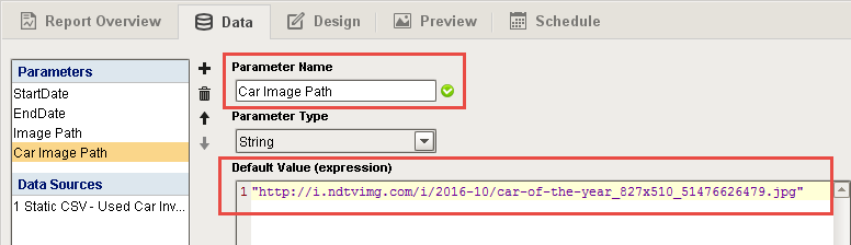

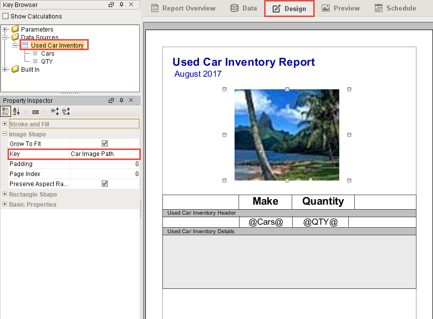

The Key property can be a parameter that dynamically constructs a path to an image which allows you to easily change images in reports without changing the actual image component. You can make an image path dynamic by dragging an Image component from the Report Design Palette into the Design panel, and creating a parameter for the image path. The expression for the Image Path parameter can be a path to a local drive, shared drive, or webpage.
Note that reports always execute on the Gateway, so the file path is always relative to the Gateway.
To create a parameter, go to the Data panel, and click the plus icon to add a parameter. In the expression block, enter in a link from a webpage using double quotes around the path name.

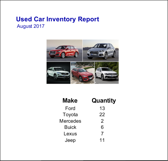

Go to the Design Panel, click on the placeholder image, and expand the Parameters folder in the Key Browser. Drag your new parameter (i.e., Car Image Path) into the Key property of the Property Inspector. The image associated with the parameter in the Key property will be displayed in the Preview panel or when the report is executed.
Go to the Preview panel and you'll see the placeholer image was replaced by the image associated with the parameter in the Key property.
