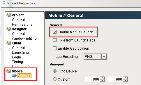

The following requires that the mobile device has network access to the Ignition Gateawy. Additionally, at least a single project exists on the Gateway, and the project must be enabled for mobile launch. This property can be found under Project Properties:

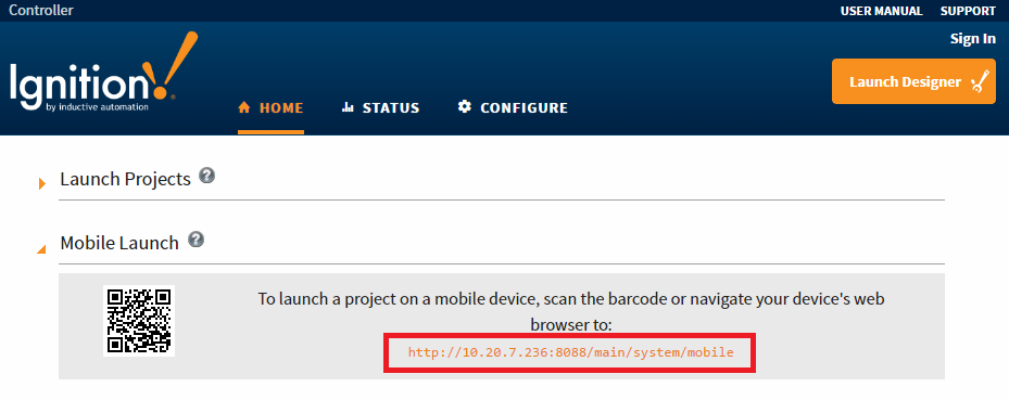

The Home tab of the Gateway Webpage contains a Mobile Launch link.

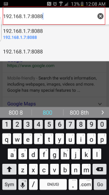

Launch a mobile project on the device by either using a barcode scanner app, or type the launch link into a browser on the device.
Since the mobile device has network access to the Ignition Gateway, the browser on the device can navigate to the Gateway Webpage directly. This way the project can be launched by clicking on the link from the device.

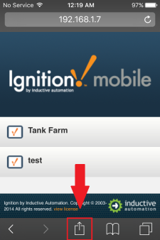

If multiple mobile-enabled projects are present, a project listing page will appear.

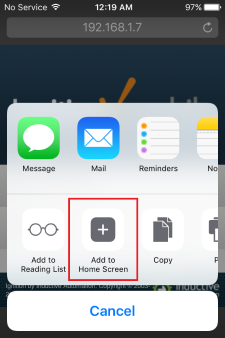

Step 2 - Add a Shortcut to the Device's Home Screen​
The second step differs depending on which mobile device you are using.
note
The following instructions assumes Chrome will be used. If using a different browser, please see the browser's documentation for adding a link to the Home screen.

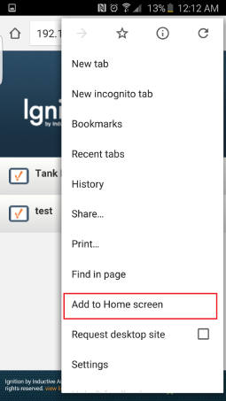

Next to the page's URL press the More icon.
A list of options will appear. Press the Add to Home screen option.

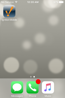

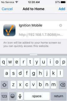

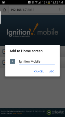

Name the link that will appear on the Home screen and press Add.

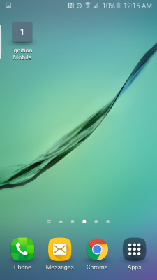

The link will now be available on the Home screen.
