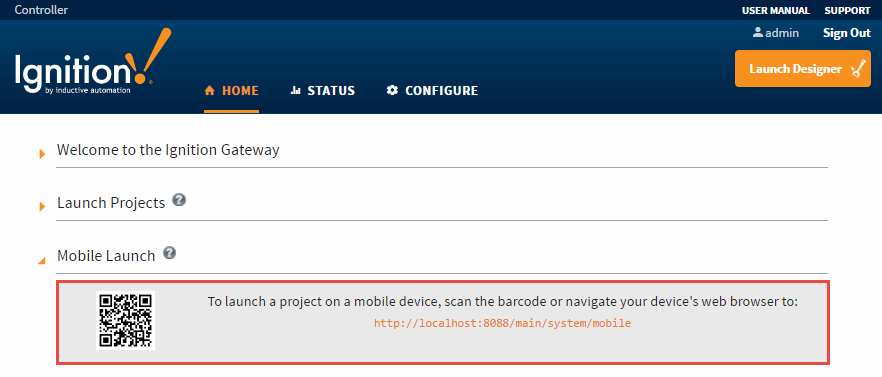

  1. Go to the Gateway Home page.
  2. In the Mobile Launch section, click on http://ipaddress:8088/main/system/mobile. This address will need to be changed to reflect the computer that your Ignition system is installed on. The Client launches on your mobile device.

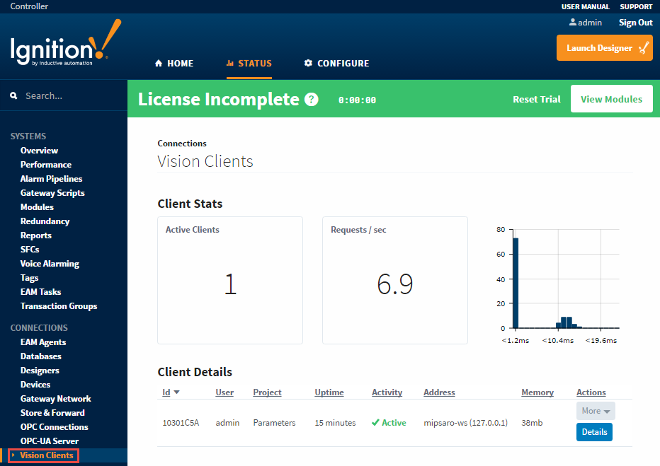

  2. To check how many Clients are launched, go to the Status > Vision Clients page of the Gateway.

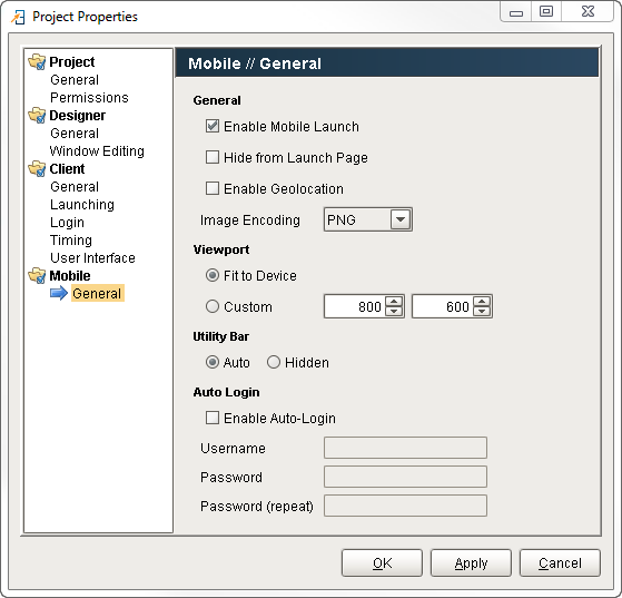

In the project properties in the Designer, there is a page specific to Mobile clients if you have the mobile module installed. Here you can enable the project for Mobile, set fit, auto-login, and more.
When designing or viewing your project from a mobile device, whether it is a tablet or a mobile phone, you want to make sure your device's pixel resolution is picture perfect. You can use the default mobile client size setting to "Fit to Device," or you can set a custom pixel size.
