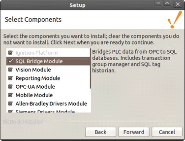

  7. Select either the Typical or the Custom installation mode.
    The Typical mode installs everything that you need to get started.
    The Custom mode lets you add optional modules, such as the OEE Downtime module. It also lets you control and select which modules get installed.
    If you select Custom Mode, the Select Components window is displayed.
    • In Graphical mode to view a brief description of the module, click on the module name. Selecting the check box next to a module installs the module as part of the Ignition installation. Clearing the check box next to a module prevents the module from being installed.
    • In Text mode a list of all the modules are displayed one at a time. Type y to install the module, and type n to prevent the module from being installed.
