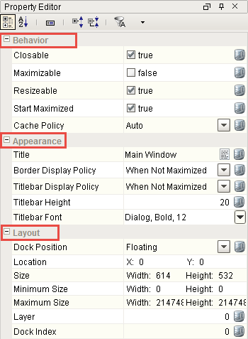

There are a number of window properties that change the way the windows look and behave. The commonly changed properties are: Closable, Maximizable, Resizable, Start Maximizable, Title, Border Display Policy, Titlebar Display Policy, Dock Position, and Layer.
You can modify these window properties, just like a component's property. Simply select the window by clicking on the window's name in the Project Browser, and while it is open, set the properties in the Property Editor.
Window Properties
Here is a description of all the available window properties in the Property Editor.
