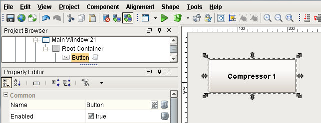

  1. In a Main Window (parent window) drag a Button from the component palette to your window and call it 'Compressor 1'.
    Setting up the Main Window Step 1

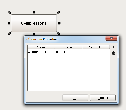

  2. Add a custom property which will pass the compressor number to the popup window. Right click on Compressor 1, select Customizers > Custom Properties. Specify the property named 'Compressor' with a datatype of 'Integer' and click OK.
    Setting up the Main Window Step 2
    The Compressor property is now created and displayed in blue in the Property Editor under Custom Properties.
    Setting up the Main Window Step 2b

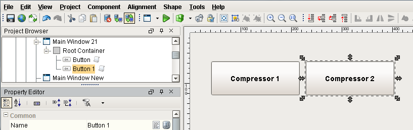

  3. Now, create a second compressor button. A quick way to do this is duplicate (Ctrl+D) the Compressor 1 button so it inherits the custom property, and label it 'Compressor 2'.
    Setting up the Main Window Step 3

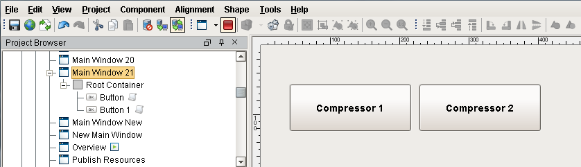

  4. From the Property Editor, change the values for each of the compressors to represent Compressor 1 and Compressor 2, respectively:
    1. For the Compressor 1 Button, change the value to '1'.
      Setting up the Main Window Step 4a
    2. For the Compressor 2 Button, change the value to '2'.
      Setting up the Main Window Step 4b

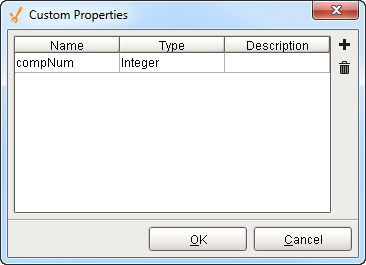

  2. Now, create a custom property on your Popup window that will receive the passed parameters. Right click on your window and select Customizers > Custom Properties. The Custom Properties window will be displayed. Specify a Name for the Custom Property, for example, name it compNum, and click OK.
    Setting up the Popup Window Step 2
    The Custom property is created and displayed in blue at the bottom of the Property Editor.

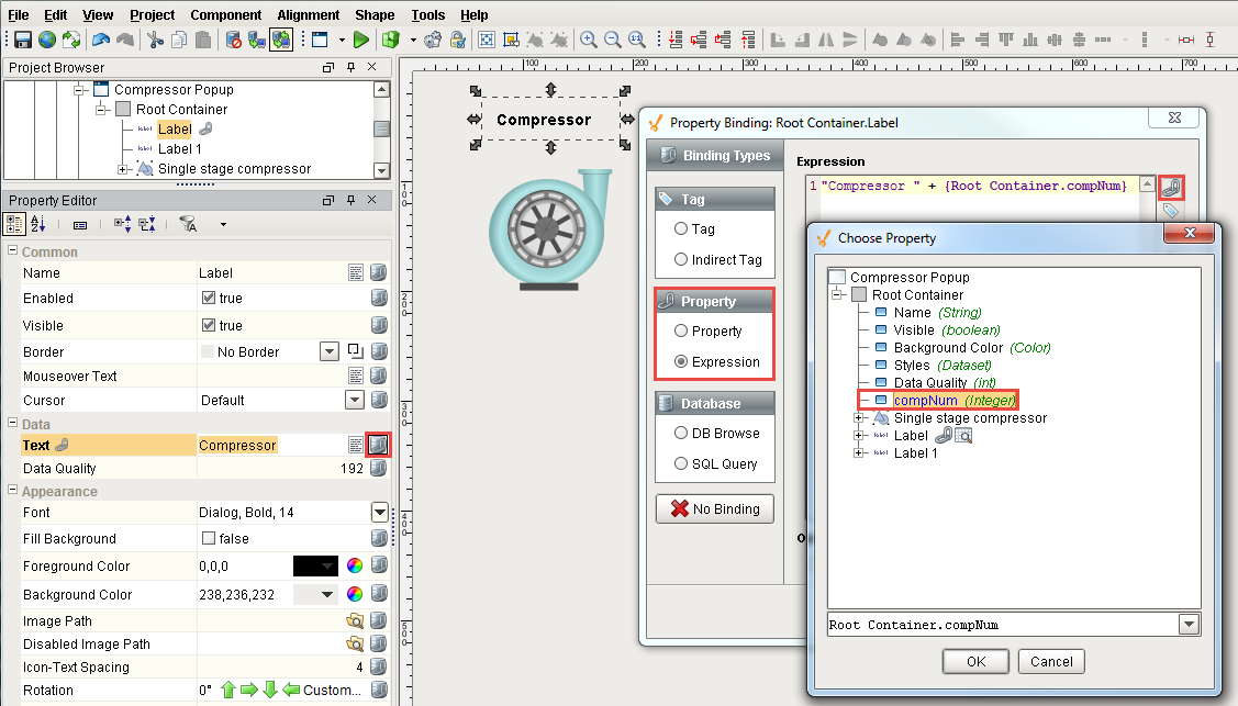

  3. Let's use an expression on the Label to change the compressor number.
    1. Select the Label and click the binding icon for the Text property.
    2. Select Expression for the binding type.
    3. Click the Link icon Link icon in the Expression window and choose the 'compNum' custom property on the root container for the compressor popup window as shown in the screenshot below. You can also copy and paste the expression from the Code Block as shown below.
      Setting up the Main Window Step 3c
    Script to change the compressor number
    "Compressor " + {Root Container.compNum}

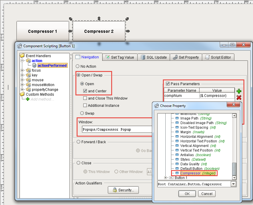

  4. One last thing to do, add the script to the buttons which read the custom property. This changes the value on the custom property from Compressor 1 to Compressor 2 or visa versa when you press the compressor buttons.
    1. Go to your Main Window, right click on the Compressor 1 button and select Customizers > Scripting.
    2. Select Open/Swap navigation.
    3. Enter your window path for your Popup Window (i.e., Popups/Compressor Popup).
    4. Check the Pass Parameters box. Click the green plus green plus to add a parameter, which will add a row to the table.
    5. Click the new row under Parameter Name and a dropdown list will appear. Ignition will automatically check the Root Container of the window selected in the Window dropdown. If you do not see the 'compNum' parameter, it may have been created on wrong component, so check the Root Container of the Compressor Popup window. Select the custom property 'compNum'.
    6. With the row highlighted, click the Link icon Link icon and navigate to the folder where the compressor buttons are located and select the 'Compressor' custom property. Press OK twice. Repeat this step for the Compressor 2 button.
      Setting up the Main Window Step 4f

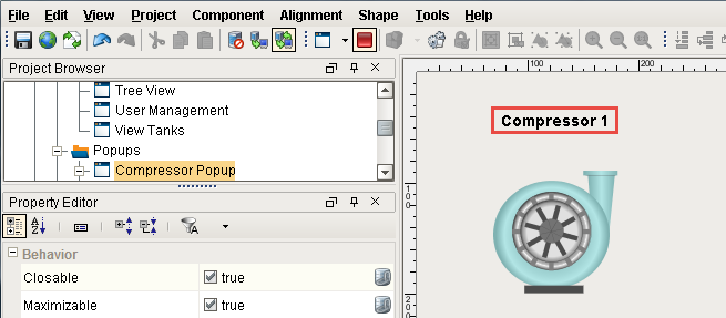

  1. Go to Preview Mode, and from your Main Window, click on Compressor 1. Your Popup Window will open and display Compressor 1.
    Test the Project Step 1a
    Test the Project Step 1b
  2. Go back to your Main Window and click on Compressor 2. This time, your Popup Window will open and display Compressor 2.
