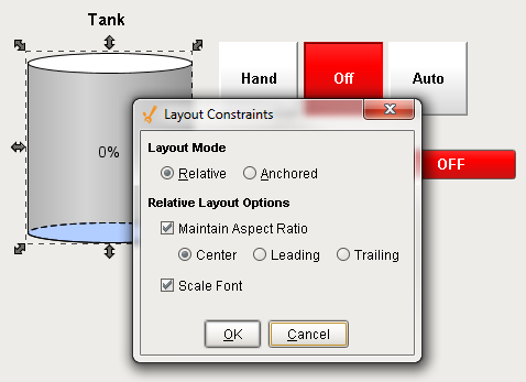

When individual components are dragged into a window, the following default Layout settings for each component are applied. All components on the window default to font scaling.
Font Scaling on Individual Components

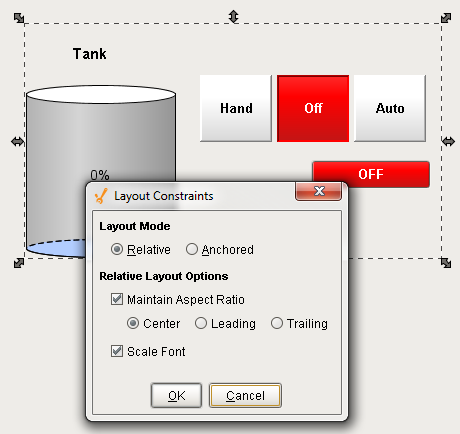

When individual components are grouped together, the default Layout settings are applied to the new group component, and to each component in the group. All the components in the group default to font scaling.
Font Scaling on Groups 1

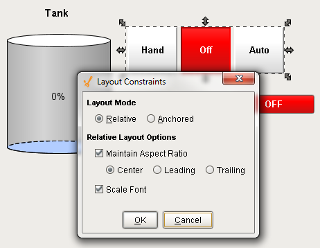

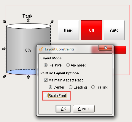

Font scaling on individual components in a group can be disabled by selecting the group, and double clicking on a single component. You will get a red outline around the group, then you can select the individual component(s), and disable font scaling.
note
The individual component font scale setting takes precedence within a group.

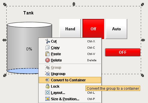

Font Scaling on Containers​
You can convert a group to a container to change the way scaling works. Ignition remembers the last Layout Settings you made to each individual component in that group prior to the conversion to a container (i.e., if any of the components had font scaling disabled, once the group is converted to a container, those same components will still have font scaling disabled).
