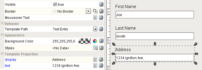

  12. To set data validation, drag a few the Text Entry templates from Project Browser to the screen or window. Notice that the text field is red.
  13. In the Property Editor, go to the display custom property and enter something like First Name. Do something similar for the other templates. Notice how the label gets filled in with the data we enter.
  14. Put the designer into Preview Mode, and enter in some values into the text fields. Notice that the background color changed to white, and the information that was entered is now in the text property that can be bidirectionally bound so that it writes to a tag or is used in a script.
