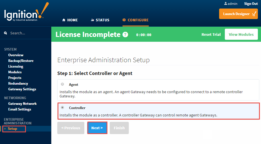

Step 1: Select Controller or Agent
Since you are installing the controller, select 'Controller' on this screen. Click Next.

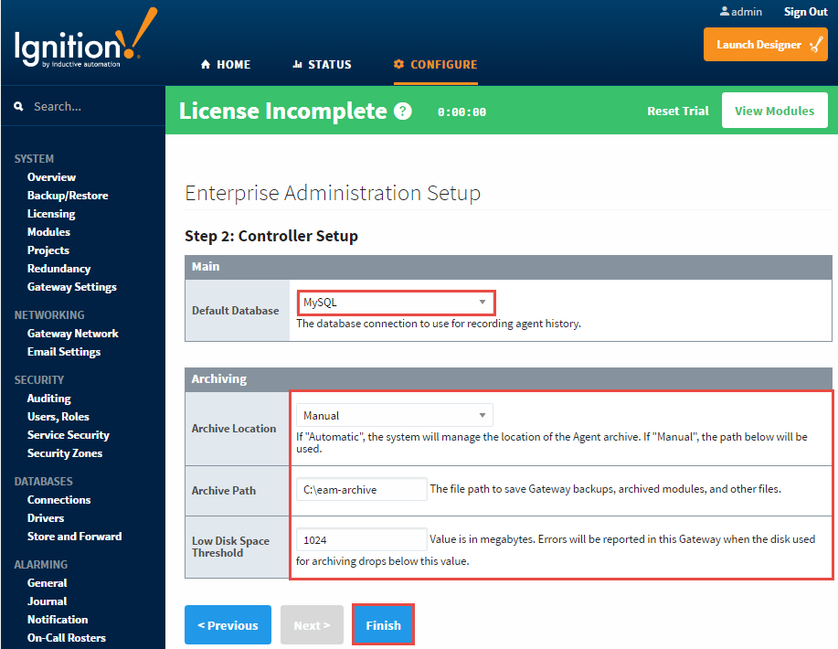

Step 2: Controller Setup
Default Database - for the default database, you must select the database connection that you created before entering the EAM Setup Wizard. If you forgot to create the database connection, you can do so now and return to the EAM Setup Wizard later.
Archive Path - this is a file path on the Gateway’s local machine where all archived files will be stored. You can use a locally mounted network share for archiving. Use a value such as 'E:\eam-archive.' It is strongly recommended that you put a system into place to externally monitor the free size of the disk that contains the archive. Gateway backups can potentially be many megabytes in size, and can eat up large volumes of space when using many agents.
After you have determined your settings, click the Finish button to save the controller settings and exit the wizard. This machine is now ready to accept agents.
Once you setup your Controller, the 'Setup' option disappears in the menu and is replaced with another list of Enterprise Administration menu options.

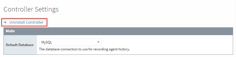

Removing a Controller​
From the Gateway, go to Configure section, scroll down and select Enterprise Administration > Controller Settings. To uninstall the controller, click the Uninstall Controller link.

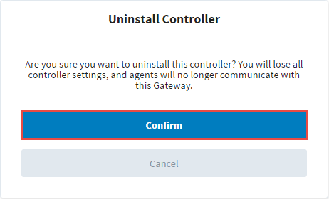

A confirmation window will appear. Click Confirm to complete uninstalling the controller.
