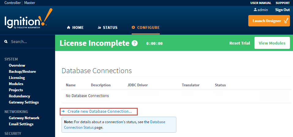

  1. From the Gateway, go to the Configure section.
  2. From the menu on the left, select Databases > Connections.
    The Database Connections page will be displayed.
  3. Look for the blue arrow, click on Create new Database Connection....
