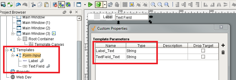

The example uses a template named Form Input. Form Input contains a Label component and Text Field component. Form Input also has two Template Parameters: Label_Text and TextField_Text
  • The Text property on the Label component is bound to the Label_Text parameter
  • The Text property on the Text Field component is bound to the TextField_Text parameter bi-directionally. This will allow the user to write to this property, and this makes reading the value later on easier.
Both Form Input and the components inside had their height set to 20 by right clicking on the components and selecting Size and Position... (Ctrl-P)

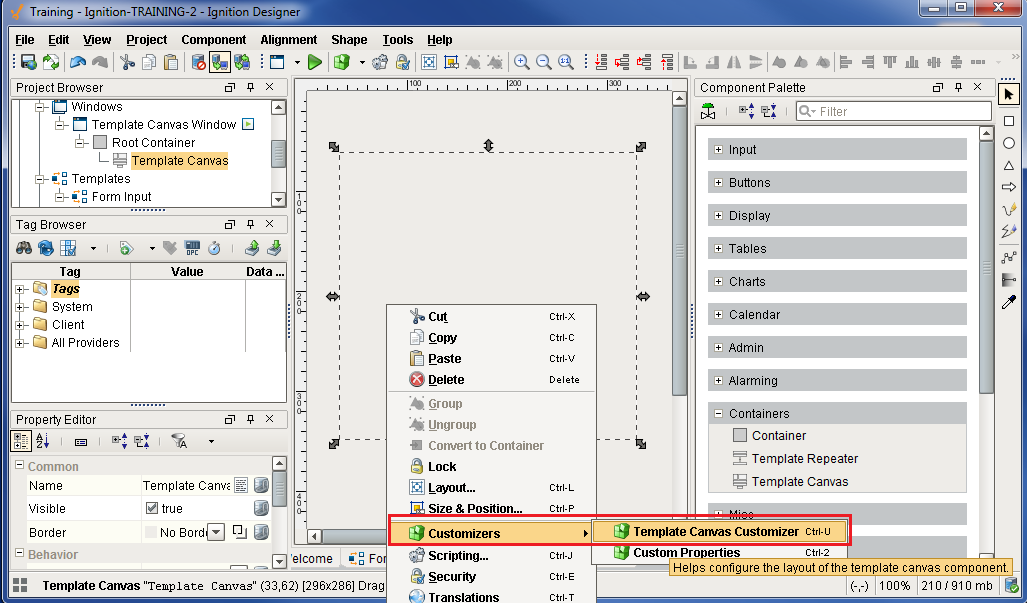

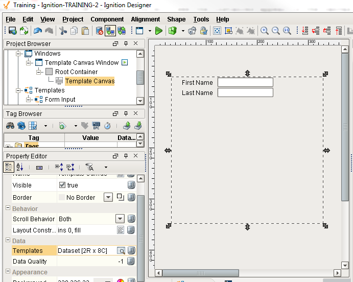

Once the template is in place, create a new window, place a Template Canvas Component down, and open the Template Canvas Customizer from either the right-click menu or Ctrl-U

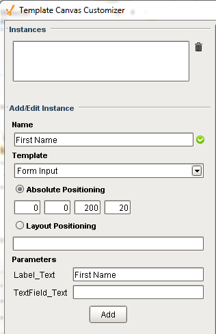

Once open, the customizer allows us to specify the location of each template instance as well the value of any template parameters. Use the following values for the first instance of Form Input:
  • Name: First Name
  • Template: Form Input
  • Position: Absolute, (0,0) [200x20]
  • Parameters: Label_Text = First Name, TextField_Text = "" (blank)

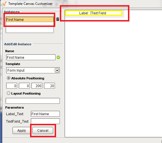

Click the "Add" button to add an instance. Doing so will add an instance of Input Field. The instance will be visible in the preview section. Note that values for the components are still using the default values for the Label_Text and TextField_Text. This is intentional. The new values will appear once we close the customizer.
Take note of the yellow outline around the instance, and how First Name is highlighted at the top of the customizer. This means that the instance is selected, and the customizer is in edit mode. This allows use to make changes to the selected instance (First Name). To exit edit mode and add a new instance click on the "Cancel" button in the lower left of the window
caution
Clicking on the "Cancel" button in the lower right will cancel out of the customizer.

Once both instances have been configured, click the "OK" button. You will see the instances appear in the canvas.

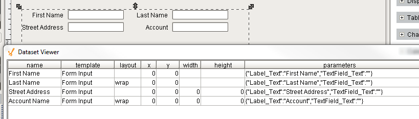

Step 2: Layout Positioning (MiG Layout)​
Instead of having to manually enter a size and position for each instance, we can make use of layout positioning to have the template canvas determine the best position for each instance, while also making suggestions as to where each instance is placed in relation to another. The layout positioning uses a grid-methodology to instance placement. Each instance, unless otherwise specified, is considered a single "cell" in the grid. We will tell the First Name instance to use the "wrap" parameter. This means the next cell in the grid should be placed on the next row.

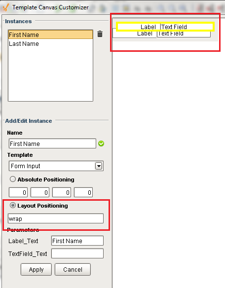

Open the the Template Canvas Customizer again, and make the following modification to the First Name instance:
  • Position: Layout Positioning
  • Value: "wrap"
Click Apply, and the First Name instance will appear to overlap with the Last Name instance. This is because the grid only accounts for instances using the Layout Positioning.

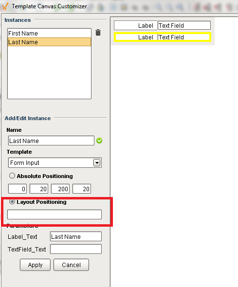

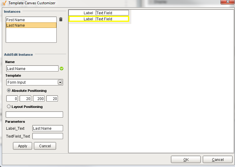

The easy way to fix this is to configure Last Name with Layout Positioning as well. Make the following changes to Last Name:
  • Position: Layout
  • Value: "" (blank)

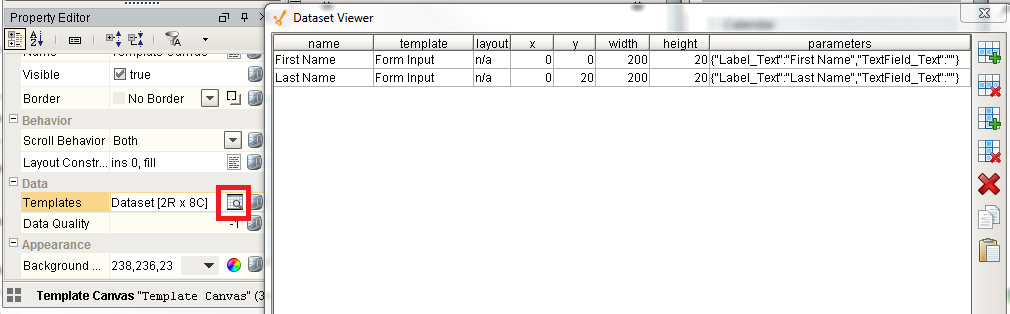

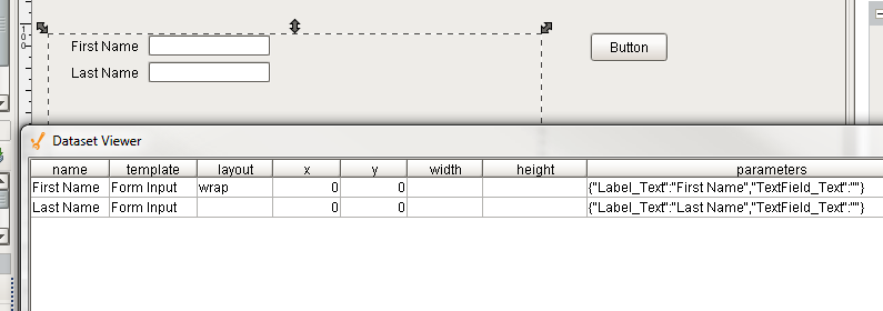

Once the changes have been applied, Click "OK". Check the Templates property again. Notice that the x, y, width, and height columns are no longer used, but the layout column for First Name now has a value.
Like the previous example, new rows can be added directly to this dataset. Furthermore, the "wrap" value means the next template instance will begin on a new line. Add two new instances for Street Address and Account Name. Use either the customizer or simply add two new rows in the dataset viewer with the following values. Note that the layout value for First Name and Last Name have been changed since the previous image:

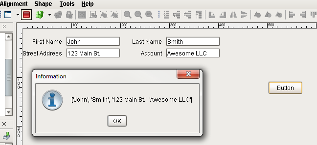

The last step is to read the user input. Put the Designer into preview mode and add some values for each text field component. Once finished, Switch the Designer back to design mode, and add a button component to the window (not the template canvas)

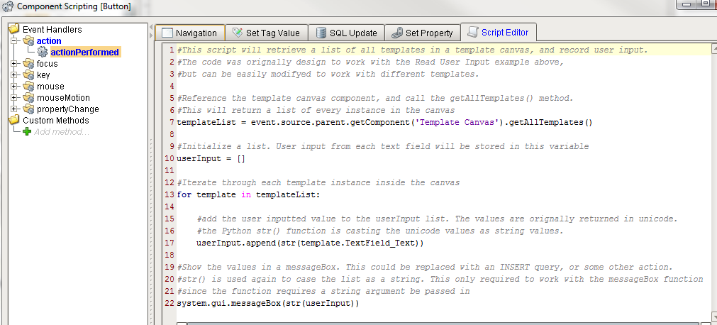

Add a script to the button component using the Code Snippet - Read User Input Example below in the Examples section. Place the code on the actionPerformed event of your button.
Click "OK" to close the Component Scripting window. Save the Project, put the Designer in preview mode, and click the button
Each value should appear in the message box. This example can easily be expanded to do something more meaningful with the input, like store to a database table.
