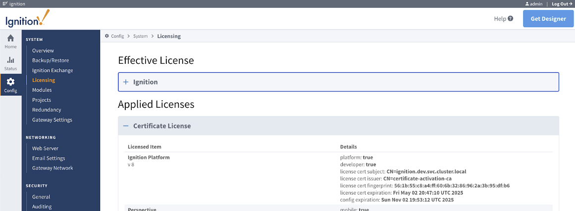

Ignition will need to be restarted for the files to be read. If everything is valid, the Config > Licensing page of the Gateway will show a Certificate License in the Applied Licenses section.
Gateway Licensing Page
For the Ignition Platform item under the Certificate License, you’ll note some details specific to Certificate Activation:
  • license cert subject: This is the Subject value of the certificate and identifies the license certificate target. Typically this will be the hostname of the Gateway for easy identification and correlation.
  • license cert issuer: This is the Issuer value of the certificate and helps to identify which Certificate Authority signed this certificate.
  • license cert fingerprint: This is the Serial Number of the issued license certificate. This label will be updated to be labeled as license cert serial number in a future version.
  • license cert expiration: This is the short-lived certificate expiration date.
  • config expiration: This is the license configuration expiration date.

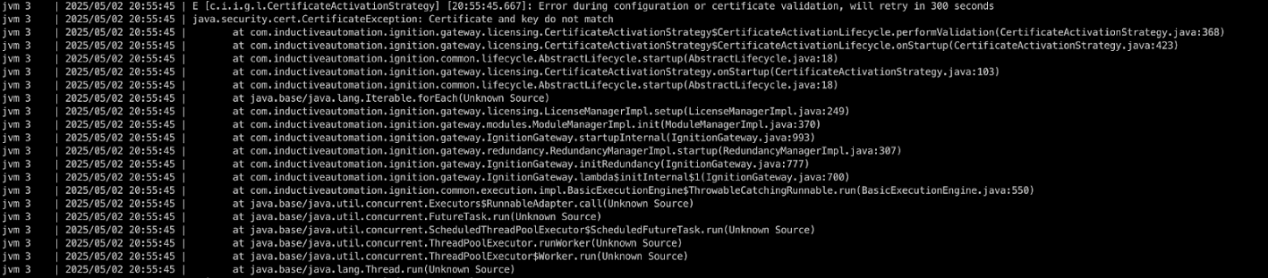

If validation fails, a license will no longer be applied. The Gateway Status > Logs page should have log entries from the CertificateActivationStrategy logger indicating the problem. The screenshot below shows an example of certificate/key mismatch.
Key Mismatch Example
The system will try to re-read the files every five minutes when there is a configuration issue. During this time, the Gateway will be in Trial mode.
