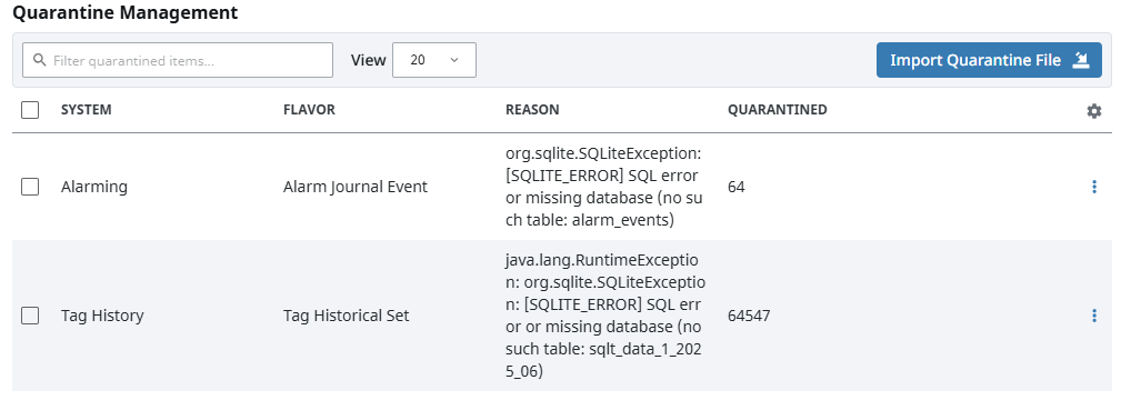

  1. From the Platform section of the Gateway Webpage, go to System > Store & Forward.
  2. Click the three dots menu and select View Details on the Store and Forward engine you would like to see the quarantine data for. The Details panel displays all quarantined data according to the order they were quarantined.
    Store and Forward Engine Details Quarantine Management

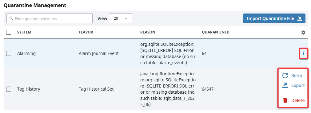

  3. Each set of data has the option to retry it, delete it, or export it for later use. Choosing export will prompt Ignition to download the quarantined files as JSON. If there are a lot of quarantined records, it may be a good idea to export and delete them so that the Store and Forward engine will not fill up and drop records.
    Quarantine Data Three Dots Menu Options

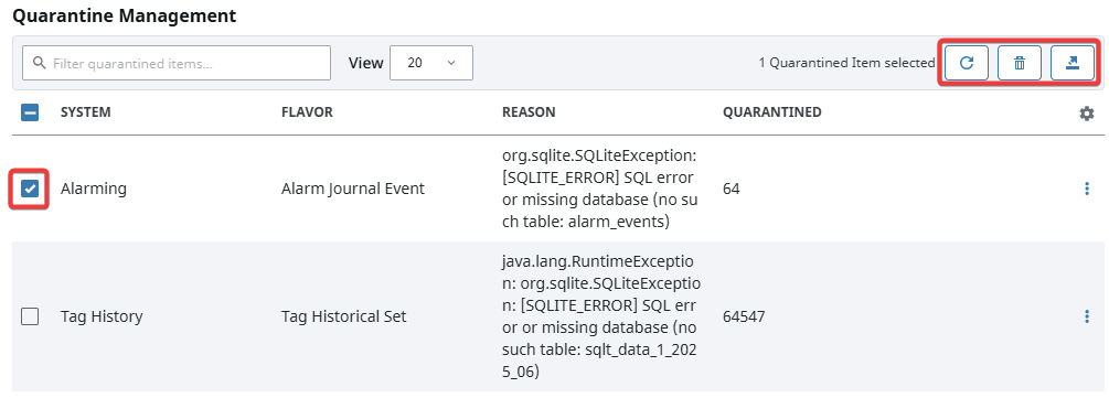

    tip
    You can select multiple kinds of quarantine data at the same time by ticking the checkboxes next to each of the items. This will allow you to retry, delete, or export all the selected data at once.
    Quarantine Item Grouping

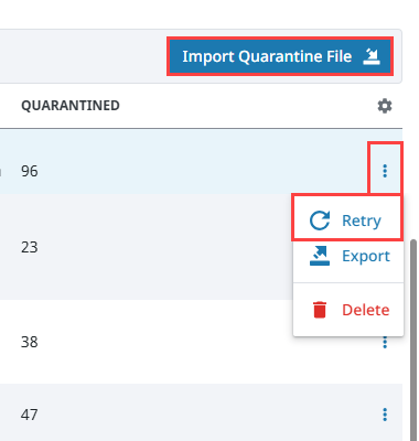

  4. Fix the problem or error you found that caused the quarantine data.
  5. Click on the three dots menu and select Retry, or if the data had been exported, import the data using the Import Quarantine File option.

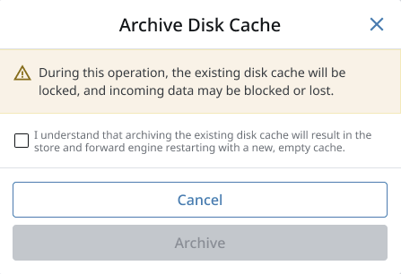

Three Dots Menu Archive Disk Cache
Attempting to archive a disk cache will result in a confirmation window, stating that the existing cache will be locked and incoming data may be blocked or lost.
Archive Disk Cache Popup
During the archiving process:
  1. The disk cache is shut down.
  2. Archived data is moved to a folder located at %IgnitionInstallationDirectory%/data/var/ignition/store-forward/.archives, making it available to load onto another existing disk cache.
    note
    The cache folder will use the following naming convention: {database name}_{timestamp}.
  3. The disk cache is started again, and a new cache folder is created.

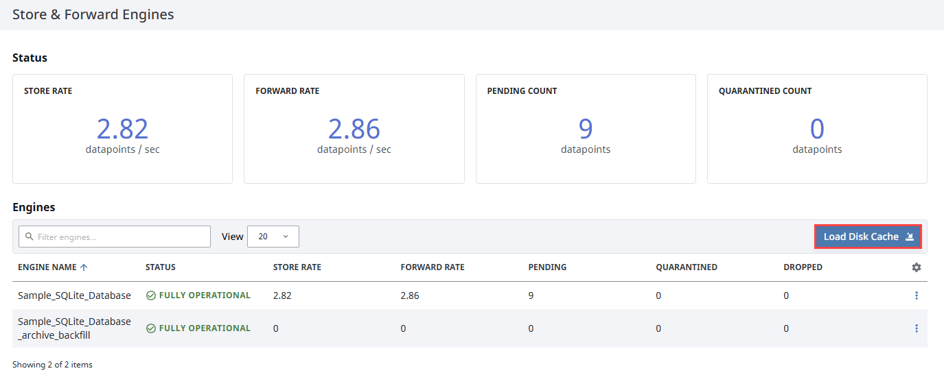

Load Disk Cache​
Changed in 8.3.10
The Load Disk Cache option has been moved from an engine's three dots menu to a shared location above the Engines list on the right-hand side of the Store & Forward Engines page. Additionally, loading an archived cache now creates a dedicated database connection and data sinks.
Load Disk Cache button

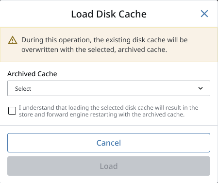

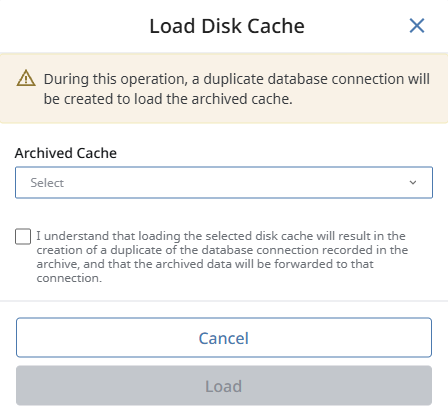

Clicking Load Disk Cache opens a popup to select the cache to load. Once selected and loaded, the archived data will be forwarded through a new, duplicated connection based on the original database connection. Duplicated connections from archived disk caches will include an _archive_backfill suffix.
Load Disk Cache Popup
Note that this new connection will also be listed on the Connections > Databases > Connections page. This is where the connection will need to be deleted from when data is done forwarding and is no longer needed.
