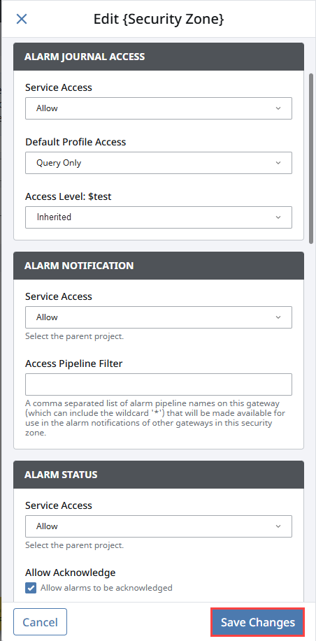

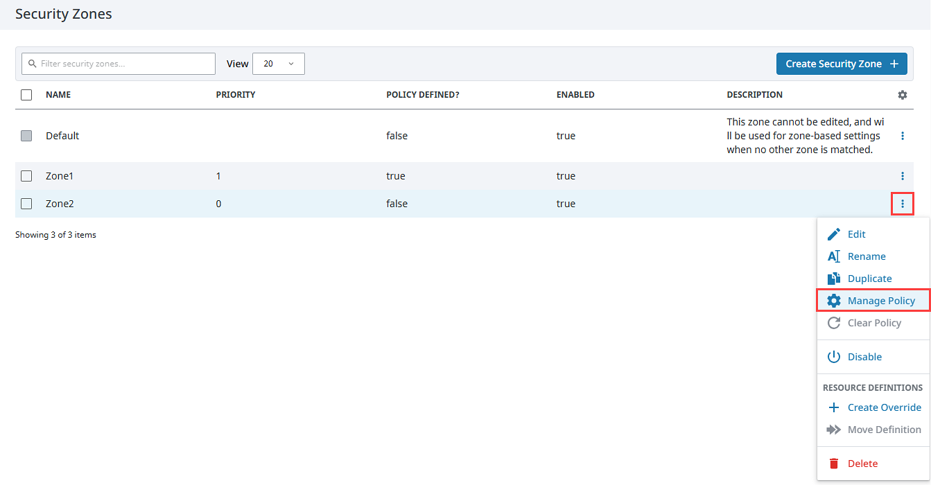

A Security Policy can be defined for each Security Zone. Security Zones and their policies can be found by going to the Platform section of the Gateway and navigating to Security > Zones. Note that the Default Security Zone cannot be edited or have a Security Policy applied. Before applying a policy, you must have a Security Zone created. Then, you can click the three dots menu for your Security Zone and select Manage Policy to open the Manage Policy panel. The following sections are available to define:
  • Alarm Journal Access
  • Alarm Notification
  • Alarm Status
  • Audit Log Access
  • Diagnostic Services
  • EAM License Management
  • History Provider Access
  • Tag Access
These sections work together to define how the local Gateway gives access to incoming Gateway connections. All sections have the ability to completely block access to specific services with the Service Access setting. Setting this to deny will prevent zone access to that particular information, regardless of how the rest of the options are set.
note
It is important to realize that if you have a single Gateway, limiting access of certain clients to certain tags is still done in the individual tags.
Alarm Journal Access Properties​
PropertiesDescription
Service AccessEnables Alarm Journal access when set to Allow.
Default Profile AccessThe default access rights for the Alarm Journal service.
Access LevelBy default this setting will be Inherited, which will cause this specific Alarm Journal to inherit the access rights set in the Default Provider Access Level. It can also be set to No Access to block query and storage to this specific Alarm Journal. Setting it to Query Only will allow users to only query data from this Alarm Journal without any storing capability. The Query and Storage option allows users to store and query data from this Alarm Journal. It is important to note that every time a new Alarm Journal is created in the local Gateway, a new setting for this journal will be added to this Security Policy.
Alarm Notification Properties​
PropertyDescription
Service AccessEnables Alarm Notification access when set to Allow.
Access Pipeline FilterA list of Pipelines in the current Gateway that other connections can use for alarm notification. Pipelines must be entered in the format "project_name/pipeline_name". The list is a comma separated list, and it can make use of the (*) wildcard. This setting is an inclusionary list not an exclusionary list, meaning that if there are no pipelines listed here, then all of them will be available.
Alarm Status Properties​
PropertyDescription
Service AccessEnables Alarm Status access when set to Allow.
Allow AcknowledgeAllows Gateways that fall within the zone to acknowledge alarms on the local Gateway.
Allow ShelvingAllow Gateways that fall within the zone to shelve alarms on the local Gateway. For this Gateway to shelve alarms on other Gateways, this must be checked on every remote Gateway.

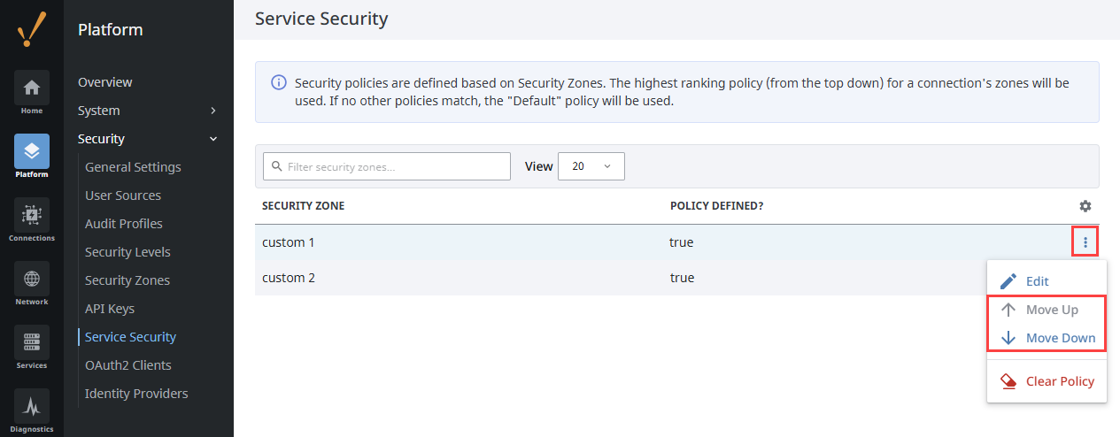

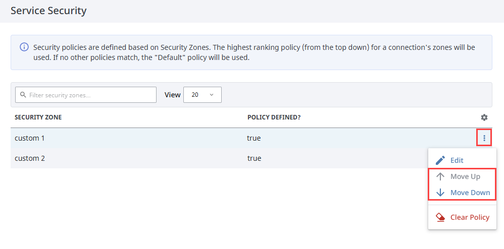

Setting Zone Priority​
When Security Policies have been defined for two or more zones, new options appear on the Service Security page when the three dot menu is expanded to move the zones up and down the list. This allows a priority to be set on the Security Zones, since a connection can apply to multiple zones. Requests from a connection, first determine which Security Zones they belongs to by starting at the top of the Service Security list and working down until finding the first zone they are in. Then, they use the access rights of that zone.
For example, say there is a custom 1 and custom 2 zone configured. Custom 1 includes specific Gateways, one of which is also contained in custom 2, that will have query and storage history access and read write edit access to tags. Custom 2 dictates all requests coming from a range of IP addresses have query only history access, and read write access to tags. We would want to make sure custom 1 is above custom 2 in priority, so that the Gateway in both custom 1 and custom 2 gets the full access rights afforded to it by the Security Policy of custom 1, instead of getting the limited access rights from custom 2.
