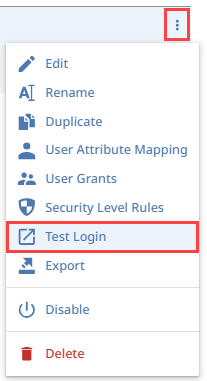

  1. From the Gateway Webpage Platform tab, go to Security > Identity Providers. The window will refresh and your list of Identity Providers will be displayed.
  2. Choose the Identity Provider and expand the three dots menu to see the actions in the dropdown list. Select Test Login.

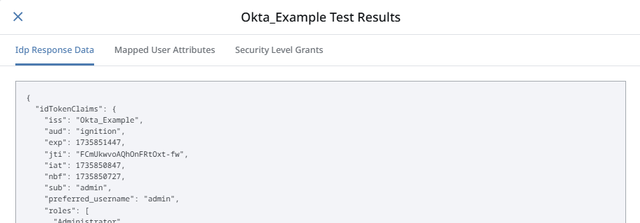

  3. Log in at your IdP's login screen.
  4. If the login is successful, you will be returned to the Identity Provider Test Results panel. The returned results will be displayed under the IdP Response Data tab.

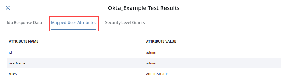

  5. Click on the Mapped User Attributes tab to view the user attributes for the currently logged in user.

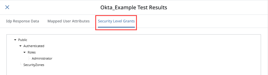

  6. Click on the Security Level Grants tab to view the Security Levels for the roles of the currently logged in user.
