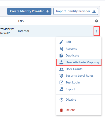

From the Gateway Webpage Platform tab, click on Security > Identity Providers.
Select the Identity Provider and click on User Attribute Mapping under the three dots menu.

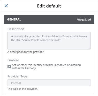

The Name, Description, and Provider Type are not editable here, but are listed on the page to make clear which IdP the User Attribute Mapping is being configured on.

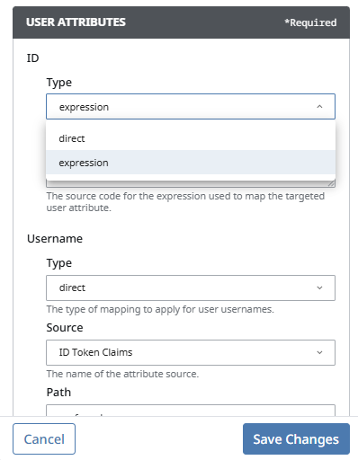

Under the User Attributes section of properties, you'll find settings for each of the mappable user attributes.
If you make changes to any of the mappings, be sure to click Save Changes when finished.

| Type | The Type of mapping to apply for the attribute. Options are direct or expression. |

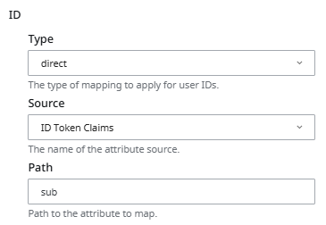

Direct Mappingβ
Direct mappings require that you enter in the path to an attribute in the response document for the given property. Values in the Identity Providerβs response document are dereferenced using the configured paths and are copied to the respective user properties in Ignition. The Source dropdown allows a particular mapping to target a specific object in the response document. The Path property then determines what object inside of source should be.
In the image below, the ID of the user, as represented on the Ignition Gateway, will be determined by the sub attribute, located in the ID Token Claims source in the response document.

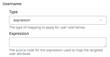

Expression Mappingβ
The Expression type allows you to use the expression language to derive the mapping from contextual data, such as the IdP response document or tags. To assist with parsing the response document in an expression, there are several built-in objects.

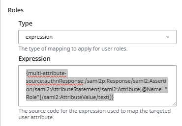

This example makes use of the Multi-Valued Object on an XML response document from a SAML IdP. Here we can use an XPath expression to examine the document and reference a specific node. We'll configure an expression type mapping that will retrieve attribute values that we want mapped to a user's Roles. Below we see the results of a test login. Our user does not appear to have any roles mapped.
If we click on the IdP Response Data tab, we see the results listed in the code block below.

In the example document, lines 68 and 69 contain saml2:AttribueValue elements, which contain the roles for our user. Starting from the roles, we can work our way back towards the top of the document, but making the following observations.
We see both elements are under a
saml2:Attributeelement (line 67). -
The
saml2:Attributeelement is under asaml2:AttributeStatementelement (line 57). -
The
saml2:AttribueStatementelement is under asaml2:Assertionelement (line 23). -
Finally, the
saml2:Assertionelement is under thesaml2p:Response element, which seems to be the root for the entire path (line 2).
Thus, we're looking for all text values of all saml2:AttributeValue elements that are under a specific saml2:Attribute element. We see that the saml2SAttribute element we're looking for also has name attribute set to "Role", which we can use to help focus our path. Based on our observations, the path looks like the following:
Note that we start at the root of the saml2p:Reponse element (on the left), and build the rest of the path in reverse order of our observations.
We specified that the saml2:Attribute must contain an attribute by the name of "Name", with a value of "Role", with which filters out the other saml2:Attribute elements in the document (such as the elements with FirstName and LastName).
In addition, we ended the path with text(), which access the text values of the nodes.
/saml2p:Response/saml2:Assertion/saml2:AttributeStatement/saml2:Attribute[@Name="Role"]/saml2:AttributeValue/text()
Writing the Pathβ
Now that we know what our path looks like, we can write an expression. We'll type the following into the "Expression" field for the Roles setting:
{multi-attribute-source:authnResponse:/saml2p:Response/saml2:Assertion/saml2:AttributeStatement/saml2:Attribute[@Name="Role"]/saml2:AttributeValue/text()}
If we then Save Changes, we can attempt a test login, and check the mapped user attributes, where we see our roles from the response document now appear mapped to our user.
