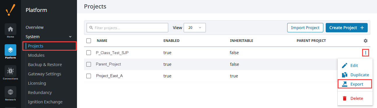

Export a Project from the Gateway​
Making an export from the Gateway Webpage exports the entire project to a .zip file. The exported file only includes resources from the project. Notably missing from the project export are any Gateway resources, even if they are presented in the Designer such as Ignition Tags. They need to be exported separately. Refer to Exporting and Importing Tags.
Remember that tags and Gateway level configurations (such as device connections, database connections, tags, etc) are not included in a Project Backup. Those resources are only exported in a Gateway backup.

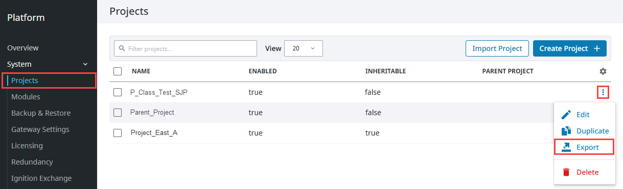

Go to the Platform tab of the Gateway Webpage, and click on System > Projects.
The Projects page will be displayed and you can see your existing projects. To the right of project name, expands the three dot menu and select Export. This exports your project as a
.zipfile. The exported file will have the project name, date, and a 4 digit unique number followed by the file extension (i.e., Compressor_2019-03-21_1123.zip).
By default, the
.zipfile is saved in your web browser's default Downloads folder. This export of the project can be imported to any other instance of Ignition that is running the same version or later.

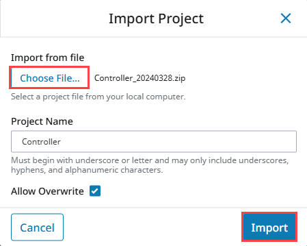

Import a Project from the Gateway​
When restoring a project from the Gateway Webpage, Ignition imports the entire project from an exported file.
The Projects page will be displayed with your existing projects. At the upper right of the screen, click Import Project.
The Import Project form will appear. Click on Choose File, find your exported .zip file from your browser, and then click Open.
Enter the Project Name. If there is already a project with the same name, the Import button will be grayed out preventing you from importing the file. The system gives you the option to Rename the project you want to import, or Overwrite the existing project.
Click Import.
If you are importing a new project, you will see your new project added to the list along with the other projects.
