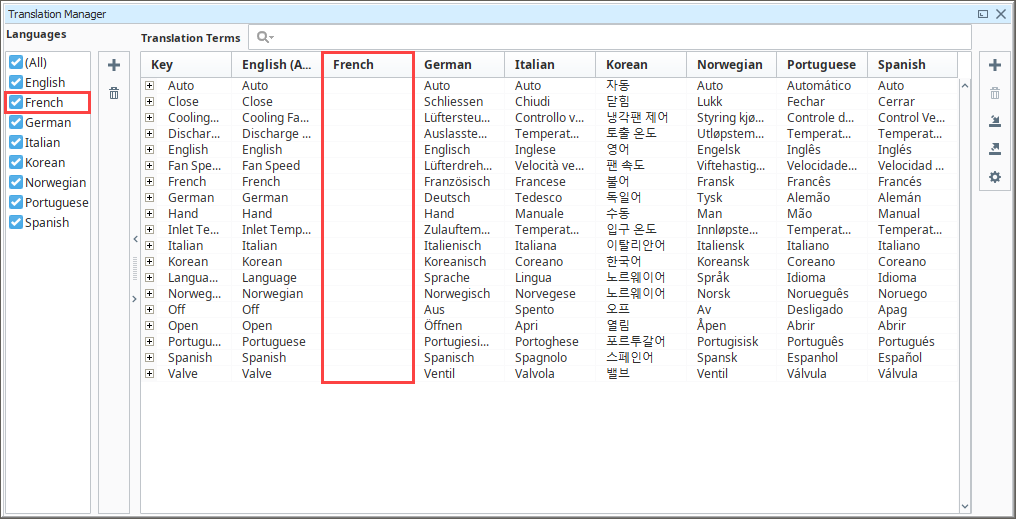

Add a New Language​
Before creating translations, you must define the languages that your project will support. The Translation Manager comes with English, French, German, Italian, Korean, Norwegian, Portuguese, and Spanish defined by default, but you can add any number of additional languages that are available. Once added, a language is available for all projects.
  1. In the Designer, go to the menu bar and select Tools > Translation Manager.
  2. In the Translation Manager, click the Plus icon next to Languages on the left side.
  3. In the Add Language dialog, select the language you want from the dropdown.
    Optionally, check Include regional variations to make region-specific codes available (for example, French (Canada) vs. French (France)).
  4. Click OK.
The new language will appear in the Languages panel and as a new column in the Translation Terms table.

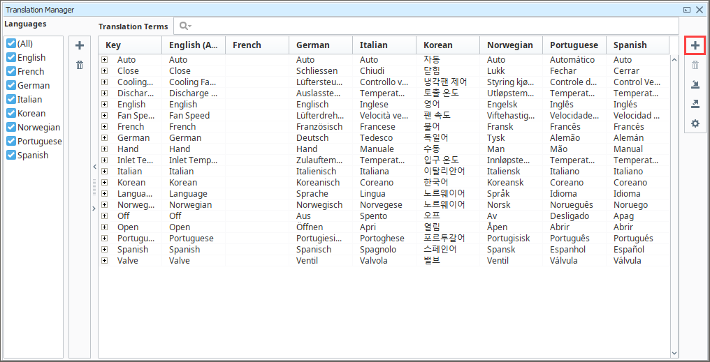

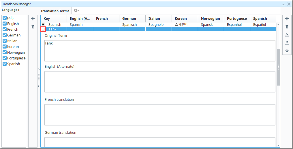

  2. In the Translation Terms table, click the Plus icon on the right side.
  3. A dialog will appear at the bottom of the table. Enter the base term for the Key column. In this example, we will use Tank.
  4. Click OK.
  5. Click the + next to the new key to expand the translation fields for each language that has been added.
  6. Enter translations for each available language. In this example, we will use "DepΓ³sito".
  7. Click Save.
The term is now available globally across projects.

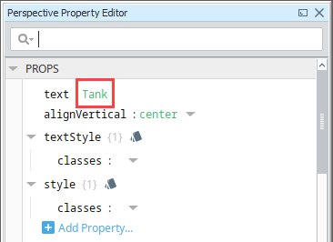

Perspective​
  1. In the Designer, open a View in the Project Browser.
  2. Add a Label component and set the text property in the Property Editor to the key you created in the Translation Manager.
  3. Change the session's locale property (for example, es-US for Spanish).
  4. Verify that the component text updates to the correct translation.

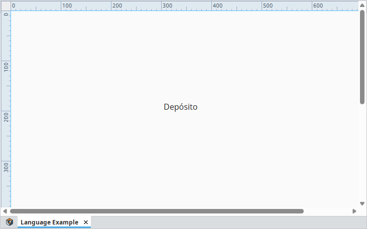

Vision​
  1. In the Designer, add a Language Selector component to a window.
  3. Switch to Preview Mode.
  4. Use the Language Selector dropdown to toggle between languages.
  5. Verify that the component text updates to the correct translation.

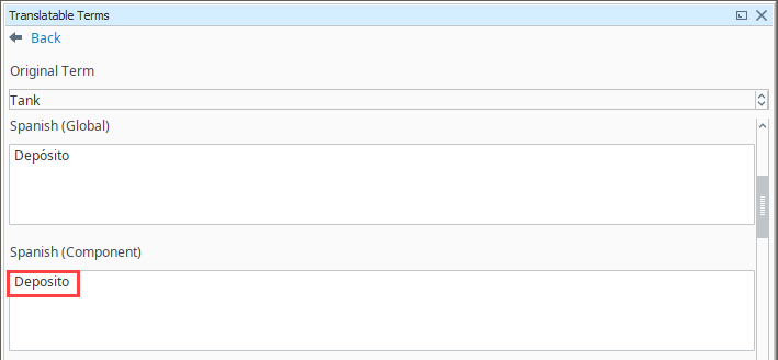

Component terms are defined in the Translatable Terms panel. This panel lists all the terms used by a component, or an entire window if opened at that level. Component terms always override global terms with the same key, allowing you to provide translations in context when a translation needs to differ in a specific window or component.
  1. In the Designer, add a Label component to a Vision window.

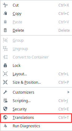

  2. Right-click the component and select Translations to open the Translatable Terms panel.
  3. Double-click the component column of the chosen language to open the and enter the translation to the Component field. In this example, we added an alternate translation in Spanish (Component).

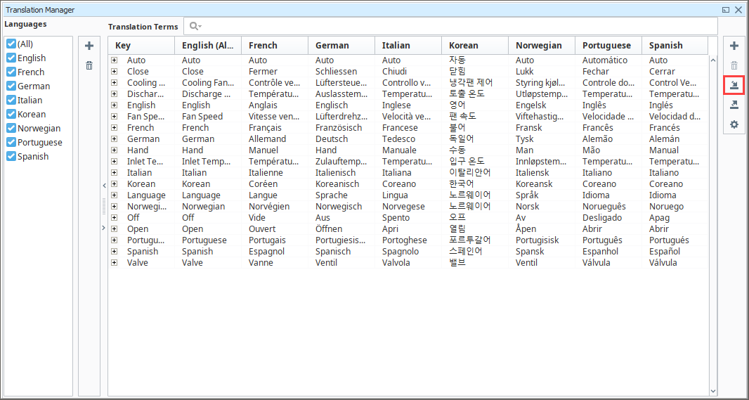

Export Terms​
You can export all terms in the Translation Manager or only selected terms.

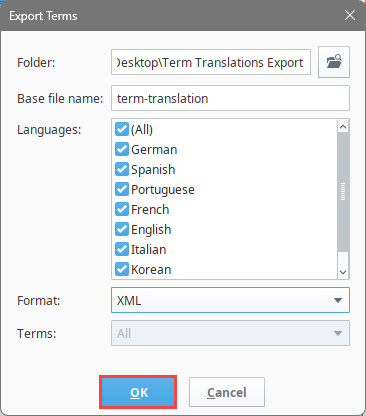

  2. Click the Export Terms icon on the right side of the Translation Manager.
  3. In the Exported Terms dialog, configure the following:
    • Folder: Choose where to save the exported files.
    • Base file name: Enter the base name for use for the exported files.
    • Languages: Select the languages you want to export. A separate file will be created for each language.
    • Format: Choose PROPERTIES or XML. XML supports UTF-8 encoding.
    • Terms: Select All or Selected depending on whether you want to export every term or only those highlighted.
  4. Click OK to generate the files.

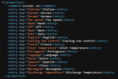

  5. Go to the export folder and confirm the files were created and verify the contents. For this example, an XML file was exported.

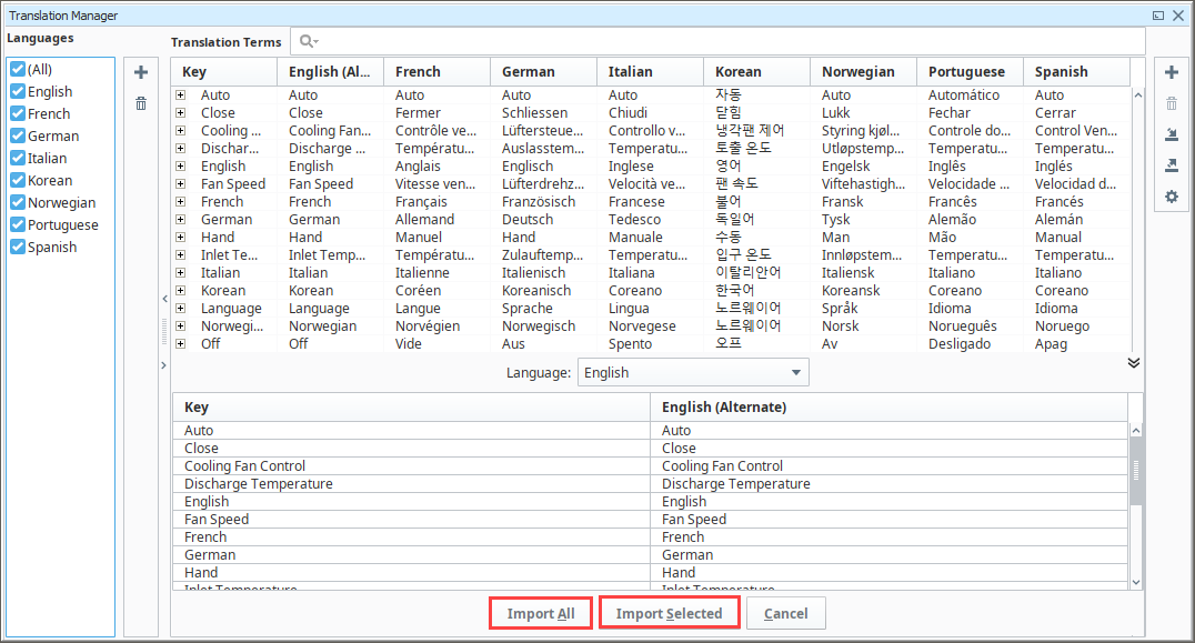

Import Terms​
You can import translation files back into the Translation Manager to quickly populate terms in another project or environment.

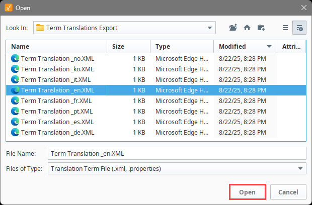

  2. Click the Import Terms icon on the right side of the Translation Manager.
  3. In the file browser, select the translation file you want to import, and click Open.
  4. In the Import Terms dialog, choose either Import All or Import Selected depending on whether you want to import every term or only those highlighted.
  5. Verify the imported terms appear in the Translation Manager.
Imported Terms Overwrite Existing Terms
If a term already exists in the Translation Manager, importing will overwrite it with the values from the file.
