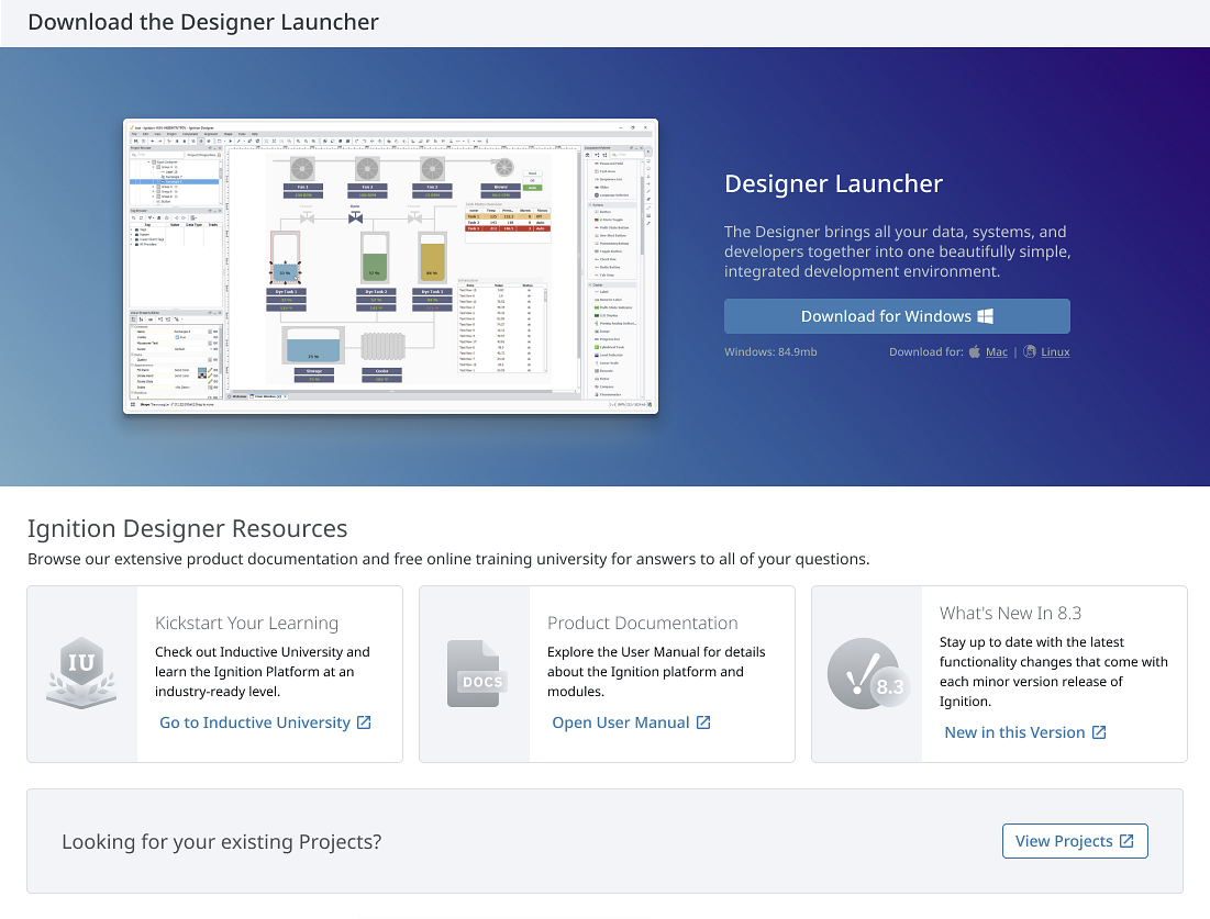

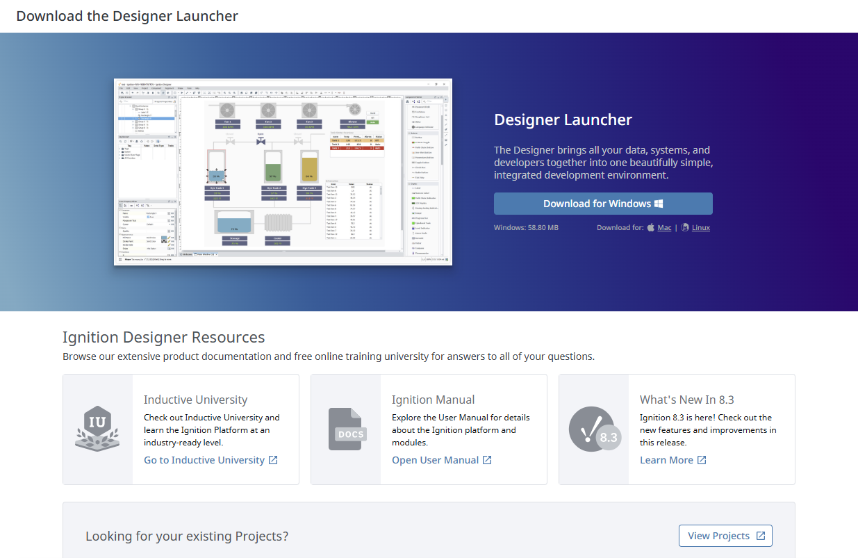

Download​
The Download page allows users to download the Designer Launcher. The download presented will be for the local operating system, but you can use the links directly below the large Download button to choose alternative operating systems.
Aside from download options, this page also includes links to additional resources like Inductive University. Selecting the View Projects link at the bottom of the page will navigate to the Gateway Platform > System > Projects page.

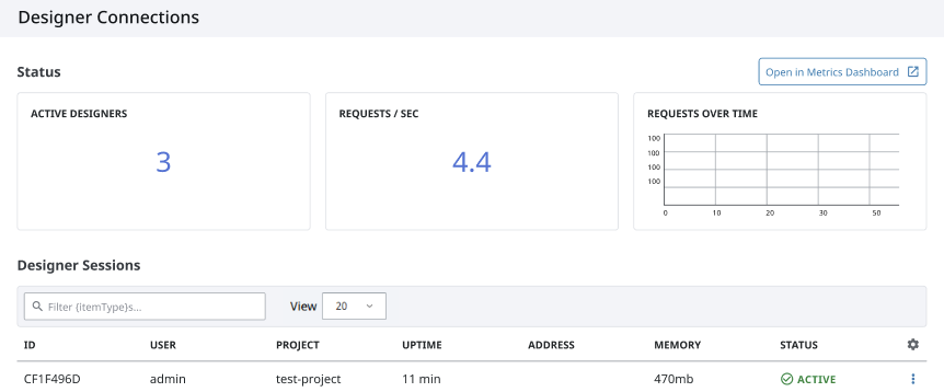

Connections​
The Designer Connections page displays information on currently running Designer sessions. All the open Designers are displayed on the page along with some basic information about each session, such as what user is logged into each Designer session and the project they are currently working on. Each listed Designer session has a View Details option that will display more information about that particular Designer.
Main Page​
The main page has a list of all currently running Designer sessions, and some basic information about all of them.
Status​
| Attribute | Description |
| Active Designers | Number of active Designer connections. |
| Requests/Sec | Number of requests running per second along with a trend showing the percentage of requests that completed in that time. |
| Requests Over Time | The timed performance of requests originating from all Designers. |

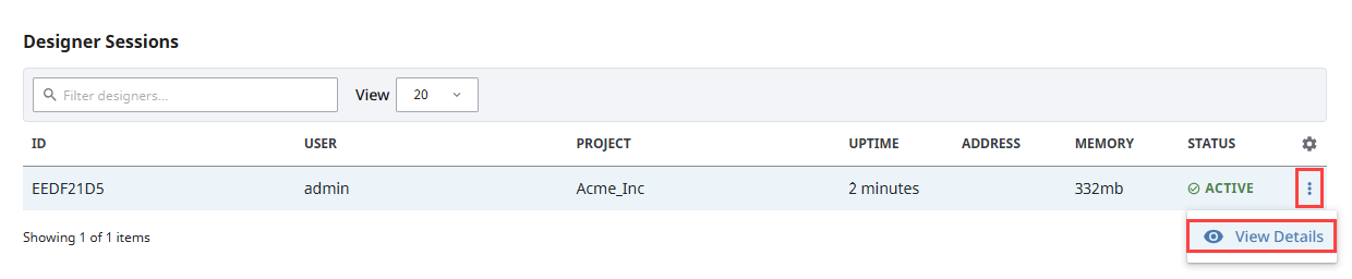

Designer Sessions​
| Filter | Search criteria to filter for specific Designer sessions. |
| View | The number of Designer sessions to preview. |
| ID | Designer session id number. |
| User | Name of the user logged into the Designer. |
| Project | Name of project the user is currently working on. |
| Uptime | Amount of time the user is logged into the Designer session. |
| Status | If the Designer is actively connected or not. |
| Address | The IP Address and name of the computer running the Designer. |
| Memory | Current memory usage for the session. |

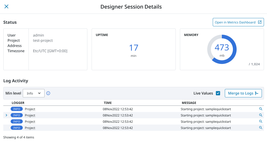

Designer Session Details​
The Designer Session Details panel shows more in-depth information about a particular Designer session. This includes user and project details, network and memory usage, the system time zone of the session, and recent log activity. The log at the bottom of the panel displays any errors or events related to that specific Designer session.
Access the Designer Session Details panel by expanding the three dots menu on the far right of the session and selecting View Details.
Status Details​
| Timezone | Local time of the user. |
Log Activity​
| Min Level | Dropdown menu with options, Info, Debug, and Trace. |
| Live Values | Toggle to enable or disable live log updates. |
| Logger | Name of the logger that describes the context of the message. |
| Time | Time of log. |
| Message | Message for the log. |
