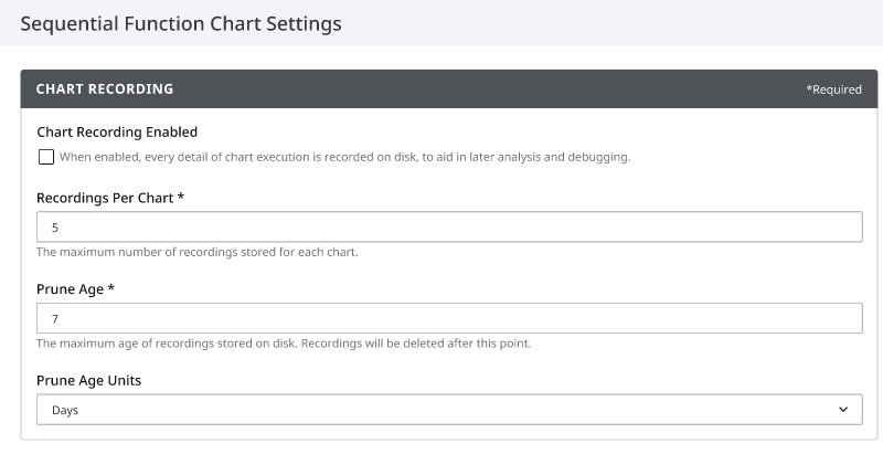

Chart Recording​
This section populates with past chart executions, and allows you to replay them from the Monitor View. Only recordings that have finished running may be examined. By default, chart recordings are disabled. You can enable recordings in the Gateway Services section under SFCs > Settings.
Chart Recording Settings​
| Setting | Description |
| Chart Recording Enabled | When enabled, every detail of chart execution is recorded on disk, to aid in later analysis and debugging. Default is false. |
| Recordings Per Chart | The maximum number of recordings stored for each chart. Default is 5. |
| Prune Age | The maximum age of recordings stored on disk. Recordings will be deleted after this point. |
| Prune Age Units | Unit of time for the prune age. Options are Milliseconds, Seconds, Minutes, Hours, Days, Weeks, Months, and Years. Default is Day. |
