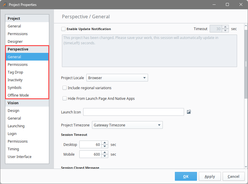

Project properties span several functional areas each containing settings applicable to that area, including:
Perspective General Properties​
These general properties apply to the Perspective Sessions.
General​
| Property | Description |
| Enable Update Notification | Enables notifications for sessions when the project is changed. When notification is enabled, this is the message that will be displayed. The token {timeLeft} will be replaced with the seconds remaining until update. If false, update will be immediate. |
| Project Locale | Select a project locale. |
| Include regional variations | Enables regional variations for the locale. |
| Hide from Launch Page and Native Apps | When selected, the project to be hidden from the Session Launcher and mobile app project listing. |
| Launch Icon | The image specified here is used to represent the project on the launch page and the Ignition Perspective mobile app. This needs to be a path to an image that has been uploaded to the Gateway. Use the browse button to choose or upload a new image. |
| Project Timezone | Timezone for this project. Dropdown list includes the Gateway timezone, Session timezone, or specific timezones around the globe. |
| Session Timeout Desktop | The time, in seconds, for that the Gateway will wait for desktop devices to respond. |
| Session Timeout Mobile | The time, in seconds, for that the Gateway will wait for mobile devices to respond. |
| Session Closed Message | Message to be displayed if system.perspective.closeSession is invoked. |
| Page Closed Message | Message to be displayed if system.perspective.closePage is invoked. |
| Logged Out Message | Determines the message displayed when a user logs out of a session. Only applies when the project requires authentication. |

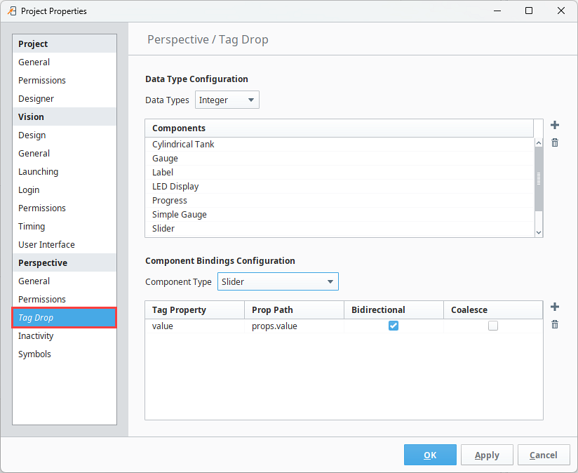

Perspective Tag Drop Properties​
Tag Drop properties provide a way to link certain data types of tags to commonly used components when dragging-and-dropping a tag onto a view. This is done in Project Properties under Tag Drop in three steps: select the data type, select the component to create, and select the bindings that are created on that component.
- Data Type Configuration: This setting determines which components show up in the popup list when dragging a tag into a view. You can switch between the different tag data types to see what sorts of components are allowed to be dropped for each of those types. Add or remove new entries in the list using the Add
icon and Delete
icon. You can then double-click on the new blank cell and select a component from a dropdown.
- Component Bindings Configuration: This setting determines which bindings are created when a component is dropped into a view. Select a component, then set up or modify the bindings for the selected component (which is typically just the tag value bound to the value/text prop on a component). Add or remove new binding entries using the Add
icon and Delete
icon. Double-click the Tag Property and Prop Path cells to fill in properties.
- The Tag Drop interface includes Bidirectional and Coalesce settings when adding components where these settings can be applied.
The Component Binding Configuration table values are tied to the component currently selected in the Component Type dropdown, they are not related to what is selected in the Data Type Configuration table above.
Dropping tags onto existing components can now create bindings on those components if the data type of the tag matches a Tag Drop configuration in the project. Tag Drop configuration is what determines if a binding is configured or not.
Tag Drop​
| DataType Configuration | This section is to set up a list of components to show for each data type that can be dragged onto the view. |
| Data Types | A dropdown list of the available data types in Ignition. Choose a datatype to see a list of components associated with it. |
| Components | A list of components associated with selected data type. |
| Component Bindings Configuration | This section is to set up bindings when a tag is dropped. |
| Component Type | A dropdown list of the available components in Perspective. |
| Tag Property | The name of a tag's property to be used in a binding. value is most commonly used. |
| Prop Path | The property path on the component where the binding will be created. props.value or props.text are most commonly used. |
| Bidirectional | A check box to indicate if the binding should be bidirectional. The Bidirectional property is set by default when adding Input Components. |
| Coalesce | A check box that when checked ensures target property changes of child properties are combined into a single write back to the source. This setting applies to Bidirectional bindings only. |

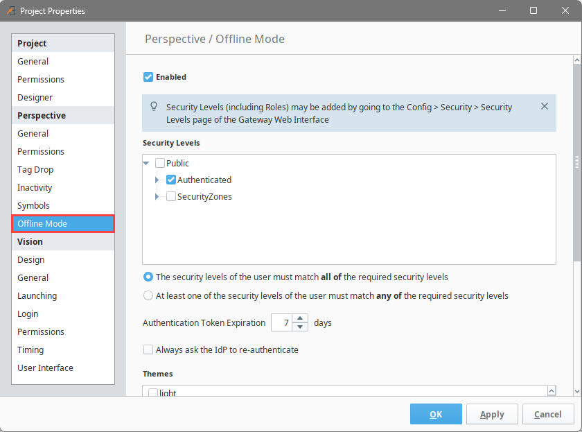

Perspective Offline Mode Properties​
Offline Mode allows users to interact with a project even when the Gateway is unavailable. When enabled, the Perspective App on supported mobile devices stores project resources locally so projects can be launched offline as well as continued during temporary disconnections. This includes selected views, supported components, authentication tokens, themes, and localization assets. Offline Mode is particularly useful for mobile and remote scenarios where network connectivity may be unreliable or intermittent.
To use Offline Mode, you’ll need to enable it in the Designer. Once enabled, any view a user visits during an online session will be available offline as well. Users can interact with components such as forms, which in Offline Mode will queue submissions for later transmission. However, Gateway-dependent features such as tag values, database queries, and script execution will not function while offline.
While Offline Mode must be enabled in the Designer, the feature only works in the Perspective App on mobile devices and is not supported in desktop browsers. See Offline Mode for full details.
Offline Mode​
The following properties control caching behavior and user access for Offline Mode.
| Enabled | Enables Offline Mode for the project. When enabled, compatible mobile devices using the Perspective App will cache project resources locally for offline access. |
| Security Levels | Defines which users are allowed to use Offline Mode. You can specify one or more required security levels. Supports All (user must match all levels) or Any (user must match at least one level). |
| Authentication Token Expiration | Duration (in days) the cached authentication token remains valid for offline use. After this period, the user must reconnect online to re-authenticate. Default is 7. |
| Always ask IdP to re-authenticate | Forces the user to re-authenticate with the Identity Provider every time the Perspective App connects online, even if the cached token is still valid. |
| Themes | Specifies which project themes should be bundled for offline use. Only selected themes will be available to users when disconnected. |
| Languages | Specifies which languages should be included in the offline cache. This limits localization assets to reduce bundle size. |
