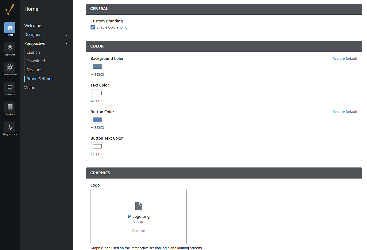

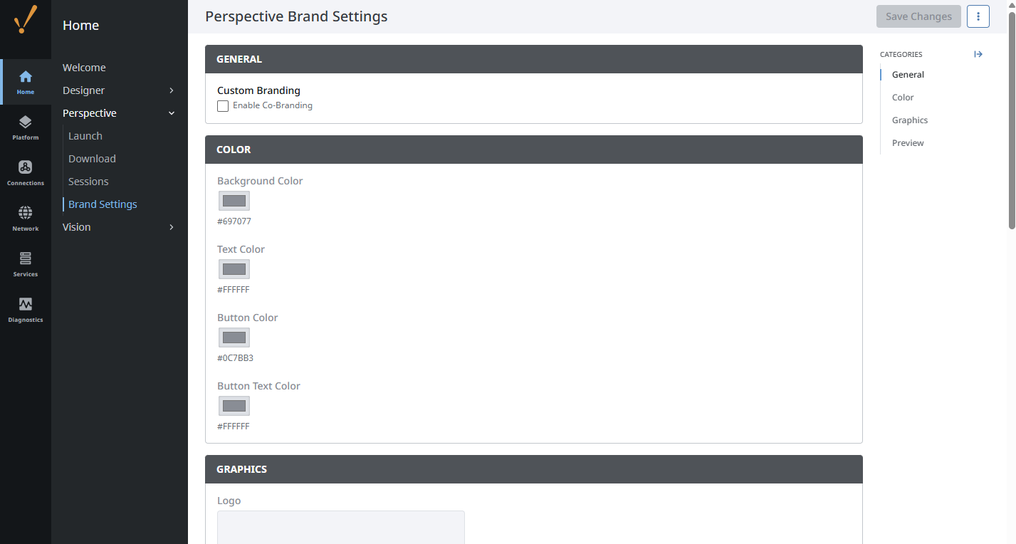

Brand properties can be configured on the Gateway by navigating to Home > Perspective > Brand Customization. This will open the Perspective Brand Settings page. The table below lists the elements that can be modified. These settings will not affect the internal contents or styles of the Perspective Session.
General​
| Property | Description |
| Custom Branding | Choose to toggle custom branding on or off. Default is off. |
Colors​
| Background Color | Choose what the background color will be. |
| Text Color | Choose what the text color will be. |
| Button Color | Choose what color buttons will appear as. |
| Button Text Color | Choose what color button text will appear as. |
Graphics​
| Logo | Graphic logo used on the Perspective Session login and loading screen. Supports .jpg or .png formats. Suggested logo size is 160x160 pixels. |
| Favicon | Favicons will appear on your desktop browser tab after Session refresh. Supports .png format. Suggested logo size is 180x180 pixels. |
| App Icon | The iOS app icon is used when saving the page to the home screen. Supports .png format. Suggested logo size is 180x180 pixels. Note that the icon used on Android devices when creating a project shortcut is set by "Launch Icon" project property. |
Preview​
| Loading Screen | Shows a preview of the loading screen with custom branding applied. |
| Login Screen | Shows a preview of the login screen with custom branding applied. |

Login and Terminal Screens​
The settings below will modify the look of the Perspective login, loading, and terminal screens:
| Property | Value |
| Custom Branding | TRUE |
| Background Color | #1383C3 |
| Text Color | #FFFFFF |
| Button Color | #1383C3 |
| Button Text Color | #FFFFFF |
| Logo | Inductive Automation Logo |
The following is the rendered output:
