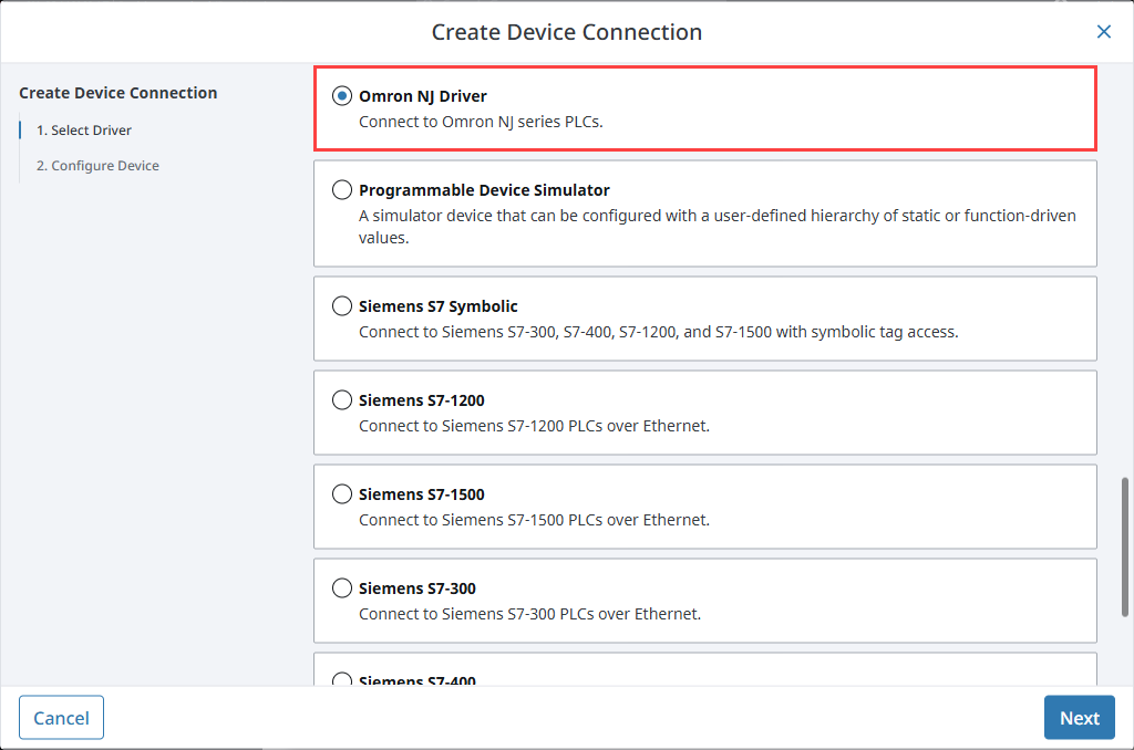

Click Create Device Connection +.
Select Omron NJ Driver and click Next.

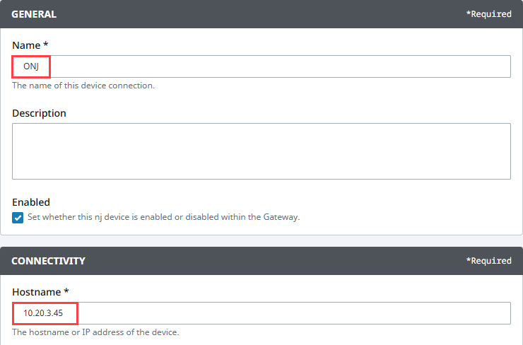

On the Configure Device screen, enter the required fields:
- Name: The desired name for the device (e.g., ONJ)
- Hostname: The IP address of the PLC (e.g., 10.20.3.45)

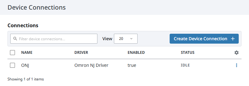

Click Create Device Connection.
The device will be listed now on the Connections page. The status will initially show Disconnected, but will move to a Connected state.

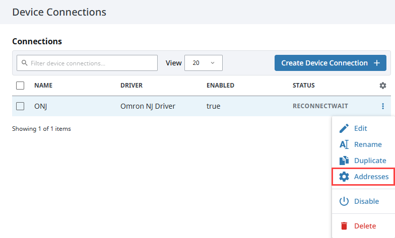

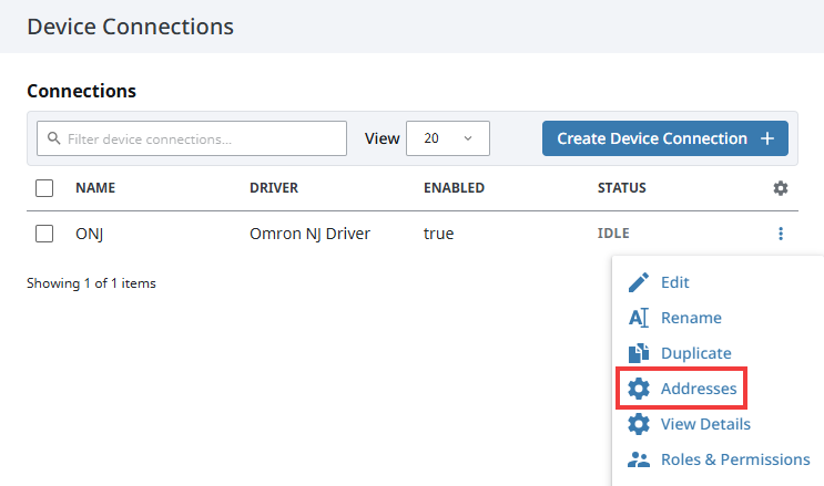

In order to browse tags in the Designer, you must first create a mapping for the device in the Gateway. You can access this by clicking the three dot menu and selecting Addresses.

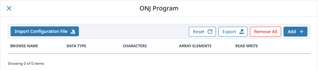

Importing Tags
To manage tags, you can manually enter the tags, or import them from a tab-separated file. When importing, first click the Import Configuration File button, then choose a file to append tags to the table.
Once you save any changes made to the tag mapping, you can view the tags in the Connected Devices window of the Designer.

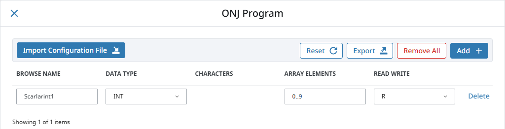

In the table of tags, we have five columns of configuration per tag.
| Column | Description |
| Browse Name | The address of the variable in the Omron device. Struct members are separated with periods. |
| Datatype | The datatype of the variable as found in the Omron device. |
| Characters | The maximum number of characters allowed for a String tag. |
| Elements | Indicates whether the tag is a scalar or an array. Refer to the section on specifying element counts for more details. |
| R/W | Specifies read/write access permissions for the tag. |

Scalars
Leaving the Elements column blank will result in a scalar tag. When reading from the device, only one element will be requested.
Arrays
Specify the number of elements in an array in the form of 0..N. The initial index 0 is always included, so an array mapped with 0..9 elements is a 10 element array.
Array elements may also be specified with a single integer representing the last offset. For example, an integer value of 5 is equivalent to 0..5.
