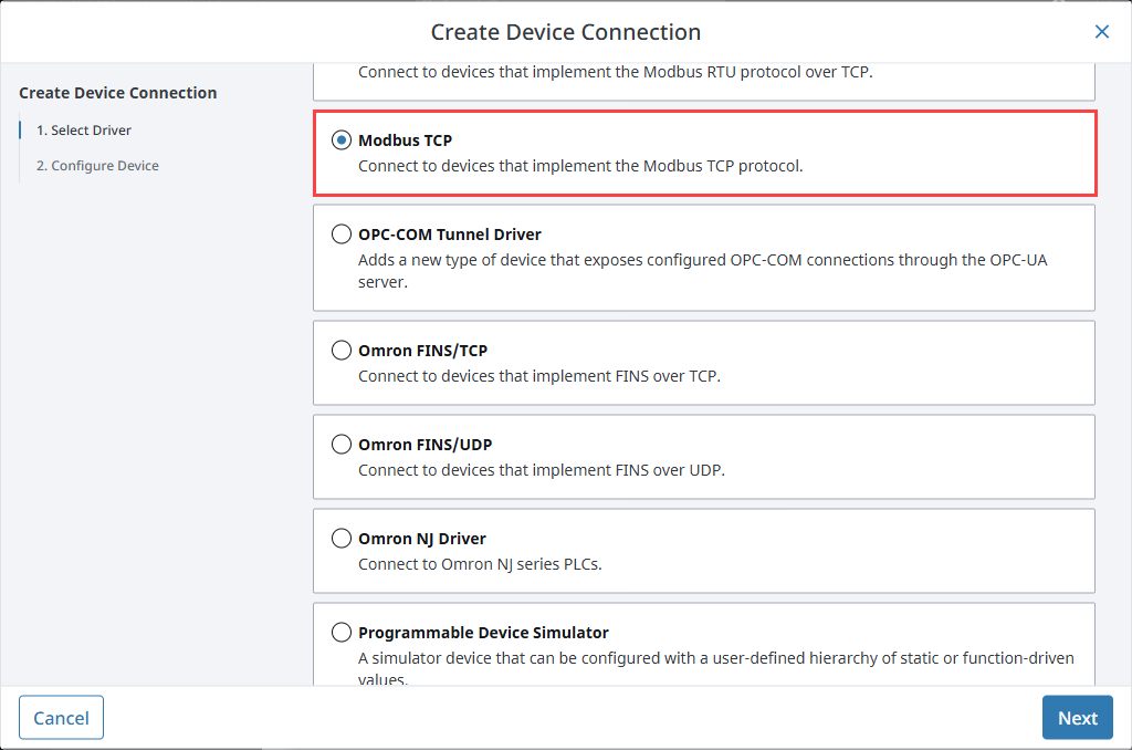

Click Create Device Connection +.
Choose a Modbus driver from the list and click Next:
Modbus TCP for devices that support native Modbus TCP/IP.

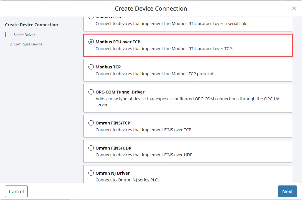

Modbus RTU over TCP for devices that encapsulate RTU messages inside TCP packets.

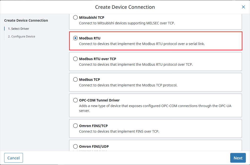

Modbus RTU for serial RTU communication.

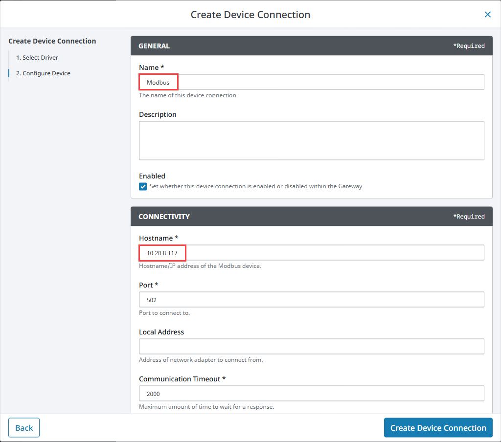

On the Configure Device screen, enter the required fields:
Hostname (TCP and RTU over TCP): IP address of the device (e.g., 10.20.8.117)
Serial Port (RTU): Serial port path (e.g., COM1)

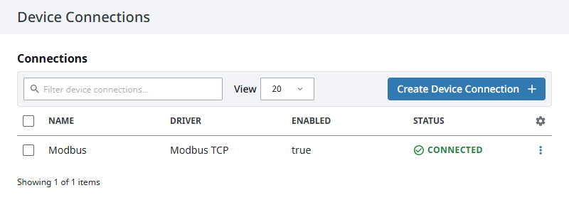

Click Create Device Connection.
The device will be listed now on the Connections page. The status will initially show Disconnected, but will move to a Connected state.
