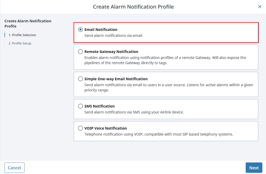

In the Gateway, go to Services > Alarming > Notification.
Click Create Profile +.
Select Email Notification and click Next.
tipIf Email Notification isnβt listed, make sure the Alarm Notification module is installed and running.

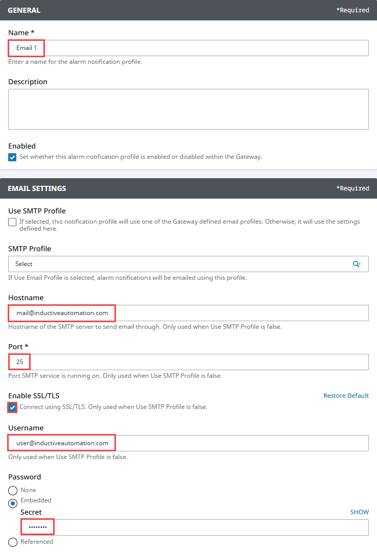

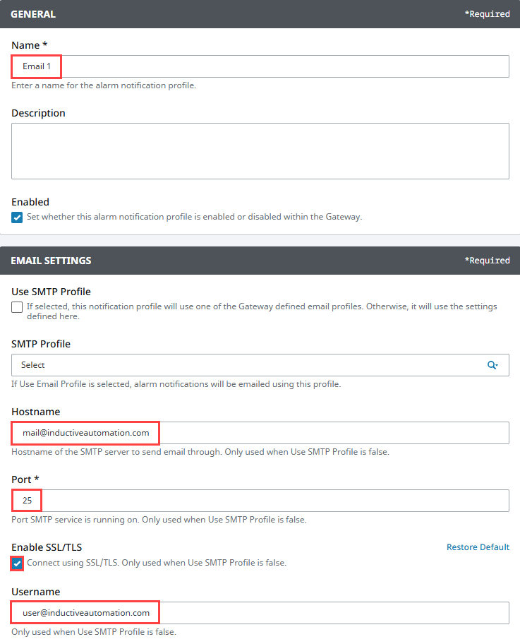

Enter values for your device into the required fields. In this example, we used the following:
- Name: Email 1
- Hostname: mail@inductiveautomation.com
- Enable SSL/TLS: True
- Username: user@inductiveautomation.com
Click Create Alarm Notification Profile.

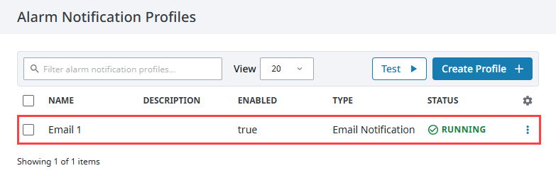

The profile appears in the list. You can now assign it to an alarm pipeline.
