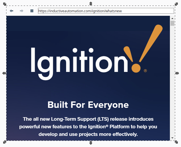

Description​
The Web Browser component in Designer allows you to embed a full web browser inside of an Ignition Client from the internet or from your local intranet inside of your projects. The browser is based on the open source project Chromium, and supports modern web technology such as HTML5, CSS, and Javascript.
