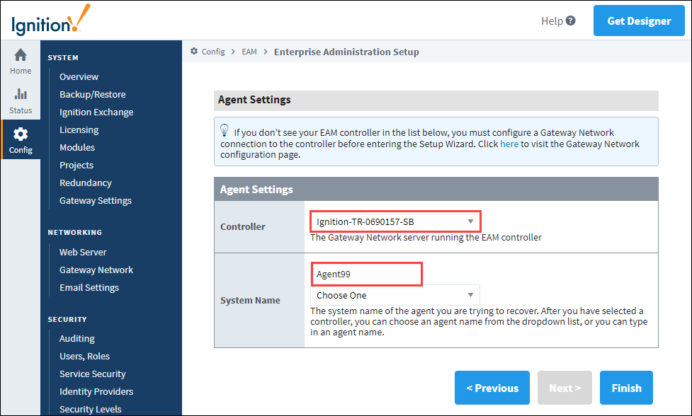

  4. Since Agent99 existed previously, the EAM remembered the Agent’s prior settings. Select from the list of names in the dropdown lists for the Controller and Agent (or you can type it in). Click Finish.

    When you get a message that the setup is complete, press Apply Files. Once you press the Apply Files button, you will see a message stating the Gateway is starting. It will take about a minute to bring the Gateway up.
    Once the files have been applied, you will see a message stating the Gateway is starting. It will take about a minute to bring the Gateway up.
  6. The screen will refresh once the Gateway is up and running. Go to the Config tab of the the Gateway webpage, and click on Projects. You will notice that all your projects were recovered.
  7. It's also a good idea to verify that all your modules are installed and running by going to the Config tab, and selecting Modules.
