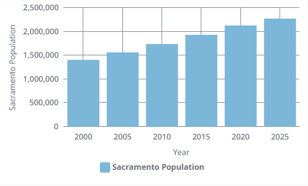

This example demonstrates how to configure a bar chart using the XY Chart component.
XY to Bar Chart
Configuring a Bar Chart Example​
In this example, we'll configure the XY Chart as a bar chart and display population data from the city of Sacramento every five years since 2000. We'll start by changing our chart to use bars instead of lines.

  4. We will now need to adjust several properties to reflect our JSON content so that our data will render. Update the settings under the xAxes.0 property to the corresponding values listed below:
    • name: year
    • label.text: Year
    • date.baseInterval.enabled: true
    • date.baseInterval.timeUnit: year
    • date.baseInterval.skipEmptyPeriods: true
    • date.inputFormat: yyyy
    • date.format: yyyy
  5. Update the settings under the yAxes.0 property to the corresponding values listed below:
    • name: sacramento
    • label.text: Sacramento Population
    • value.range.min: 0
  6. Update the settings under the series.0 property to the corresponding values listed below:
    • name: sacramento
    • data.x: year
    • data.y: sacramento
    • xAxis: year
    • yAxis: sacramento
  7. Next, navigate to the series.1 and yAxes.1 properties and delete them. We will not need a second series of data for this example.

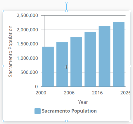

  8. You may notice that the data rendered is off-center, with bars not aligning with their year values.
    Bar Chart Off Center
    To fix this, use the handles on the XY Chart to widen the component. This will resize the chart so that the data is properly displayed.
